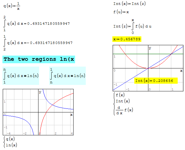

Try the formal procedure before uninstaling Maxima.
The remaining of the work sheet may not work at all.

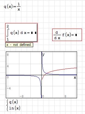

If version(s) past 5346 disable the integration operator,
to me : it is a bug by definition as exemplified earlier.
