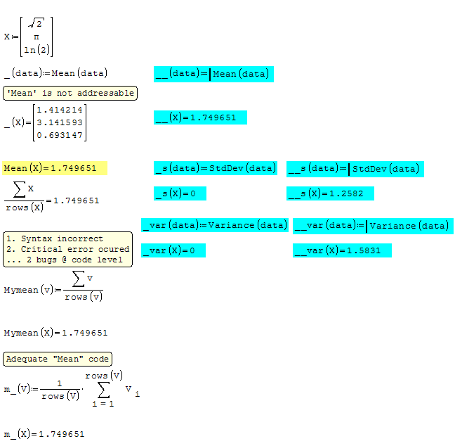

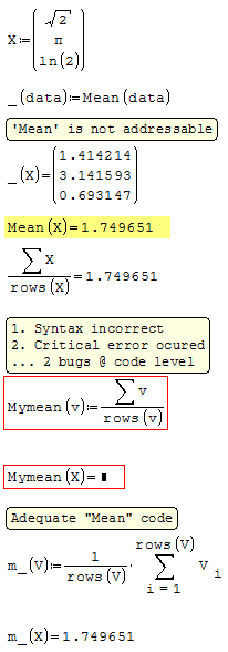

If not corrected since 5346 [official release].

#2 Опубликовано: 08.12.2016 14:11:37
It seems not quite yet

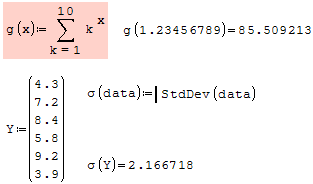

StdDev(), Variance() will give zero values. Quite strange .
Davide Carpi 08.12.2016 19:38:00
#3 Опубликовано: 08.12.2016 19:38:14
Thank you guys, I'll fix these functions ASAP
As shown in Radovan's screenshot, the second bug is fixed in current version of SS.

By the way, It seems there are some more functions affected by this bug (like Median(), Mode() etc.). I do not know how many of them might be.
P.S. It crossed my mind this bug as well - summation problem. Are these bugs connected in any way? In both situations you have to use line() environment and the calculation is Ok then.
#5 Опубликовано: 09.12.2016 10:55:23
Quite right Radovan,
The stat package understands local line definition.
5346 does not suffer the iterator problem you attached.
