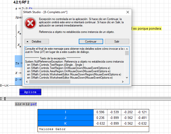

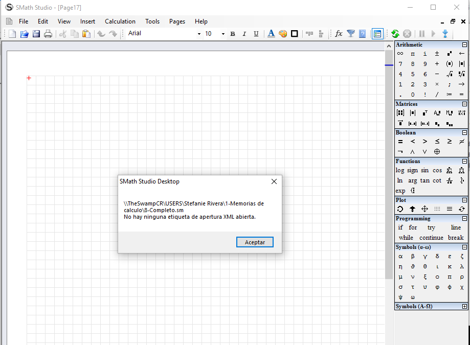

But it crashes several times sometimes with this the error in the image and sometimes just save it normal and the next day when you open it shows the xml error and don´t open more.

Other times shows this error and dosn´t open more:
This is the complete details:
error sm.txt (16,23 КиБ) скачан 1221 раз(а).
The file its large, like 37 pages.
WroteOther times shows this error and dosn´t open more:
This seems related to something messed up in a text region (a children region maybe), triggered by mouse-click. Hard to catch without a file.
