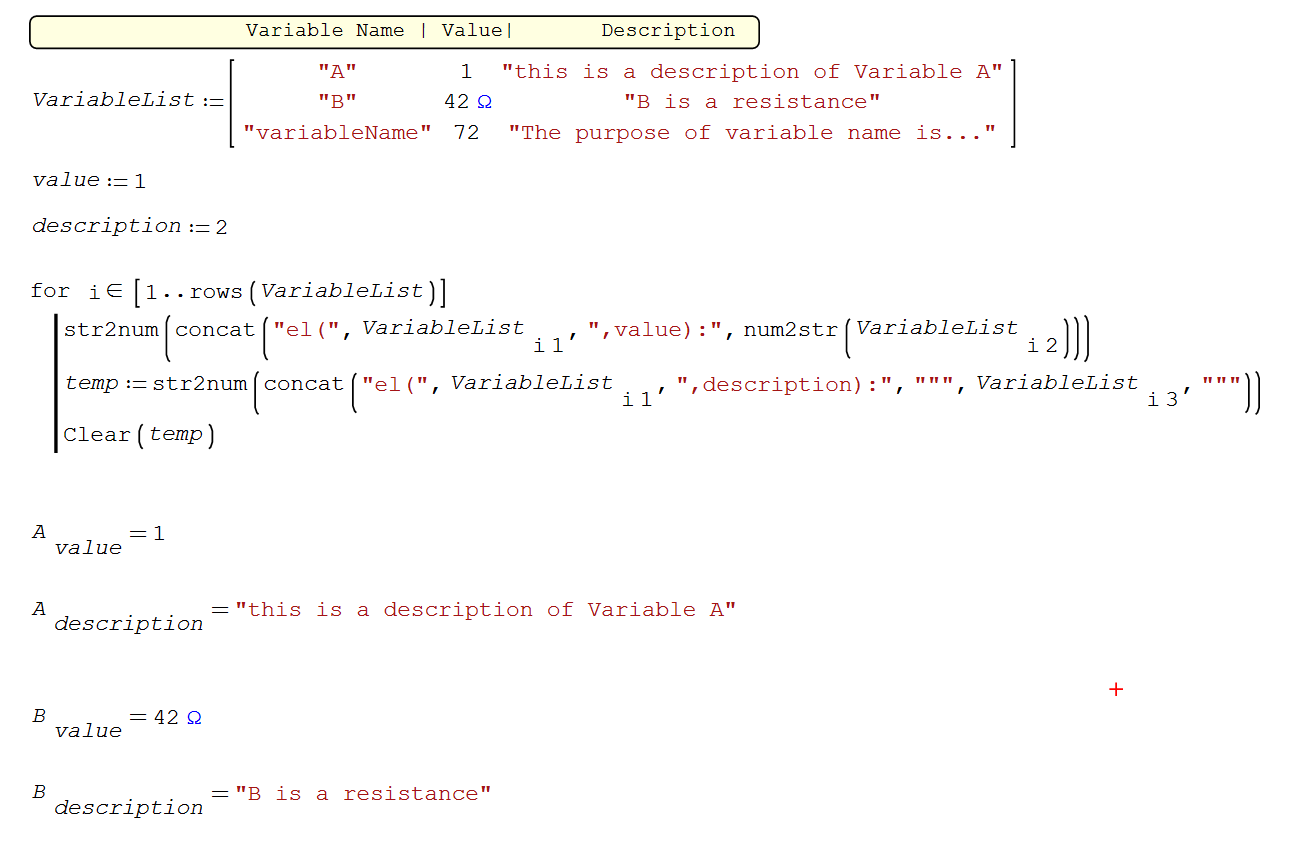

A matrix approach:
AssignValueAndDescription.sm (7,5 КиБ) скачан 1240 раз(а).
Arie 26.10.2022 09:59:00, Alvaro 26.10.2022 14:26:00

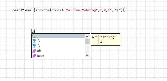

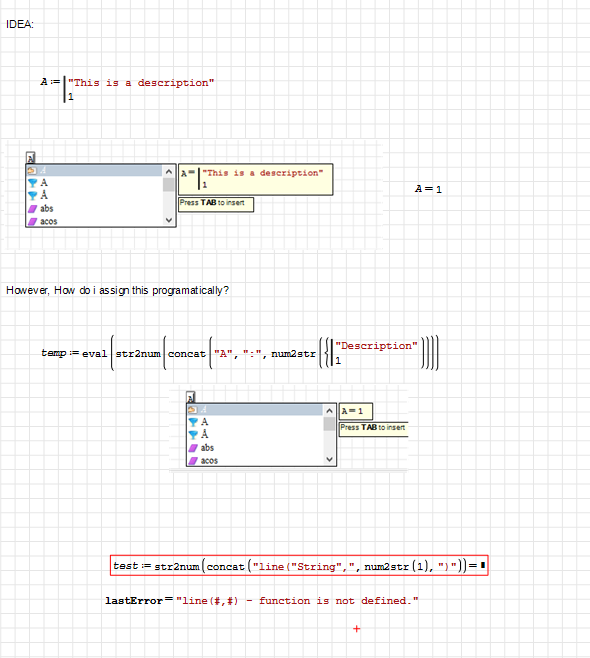

I had another idea using line function. But i'm not sure how to do it programatically... Any Ideas? Is it even possible?
Worksheet8_alternateIdea.sm (22,9 КиБ) скачан 1290 раз(а).

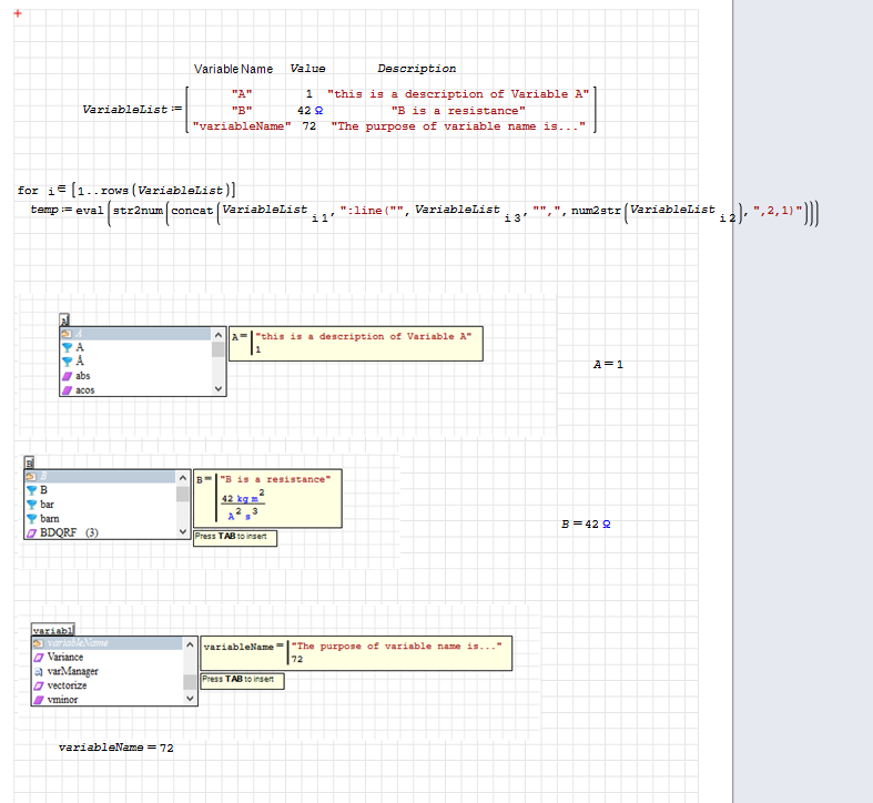

Aha! I figured it out
I'm pretty happy with this solution.
Here's my updated file for a reference:
⚜ Kenny Lemens, P.E. ᵂᴵ 26.10.2022 11:32:00, Alvaro 26.10.2022 14:29:00
