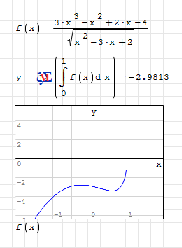

I have the following problem, trying to solve the definite integral int((3*x^3-x^2+2*x-4)/sqrt(x^2-3*x+2),dx,0,1): I get the error "x - not defined" and, of course, no result.
If I change the limits to [0..401], I get a result (!) with no error message, but if I set the upper limit lower than 401, I get the error again...
What is the reason for that?
Thanks in advance for your replies.
Conrad
#2 Опубликовано: 07.02.2019 11:13:06
The integrand is undefined @ x = 1

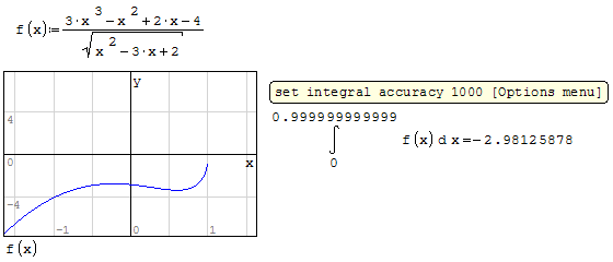

#3 Опубликовано: 07.02.2019 11:41:17
Three verdicts in there:
1. Nothing will integrate that freak above x=1.9999999999999999999999999999
2. Nothing will integrate up to x=0.99999999999999999999999999999999
3. Can only integrate in reasonable range of the integrand.
Interesting Classroom example ... always plot the integrand !!!

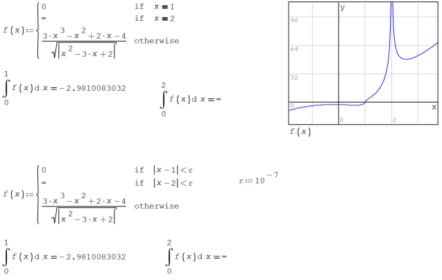

Hi. I think that here the point is how to handle avoidable discontinuities in SMath. Because integral and other operators or functions not accept the 'if' statement, you can use 'cases' in the definition of f, as this:
Even this isn't the case, this other is more general for avoiding numerical issues with avoidable discontinuities:
sergio 08.02.2019 08:59:00
#7 Опубликовано: 08.02.2019 06:47:42
1 125 сообщений из 1 798 понравились пользователям.
About the other discontinuity, at x=2, I guess that you don't want to work with complexes. It's usual take the absolute vale of logs and roots in real analysis calculus. This other isn't avoidable discont, but can be handled in a similar way.
discont_integral.sm (8,65 КиБ) скачан 1108 раз(а).

#9 Опубликовано: 08.02.2019 13:34:33
maple() also can do that.
maple [0..1] = -2.98126694400594
Mathcad 11 [0..1]= -2.98126694400554
Smath = -2.98126668567898 ... acc 10000
This is a case of singular end point

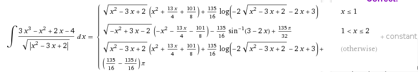

... This other isn't avoidable discont, but can be handled in a similar way.
Well, actually, the integral converges for x=2, as one can see in this wolfram result
That's means that numerical procedure for computing int in SMath needs some improvements.
