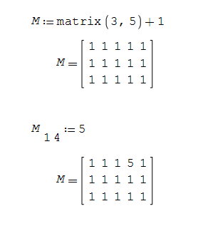

#3 Опубликовано: 28.09.2021 08:37:33

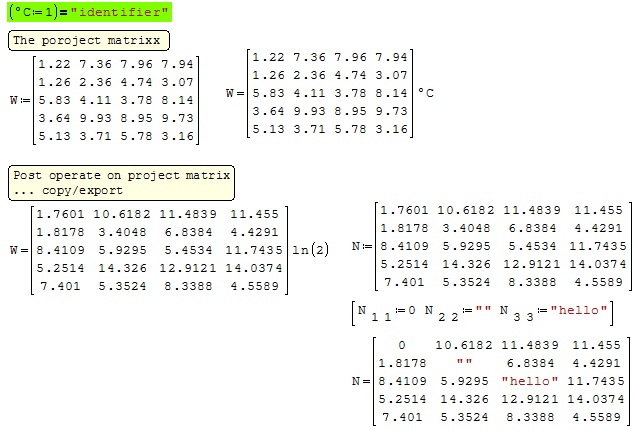

#4 Опубликовано: 28.09.2021 09:17:41
... observe the empty place holder is a / operator.

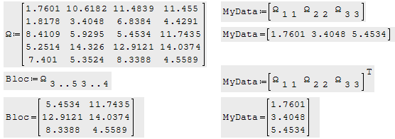

#6 Опубликовано: 28.09.2021 11:15:31
Thank You Jean, but rather, I meant to extract a specific element from the matrix.
There are many more ways ... like skinning a cat.
Cheers ... Jean.

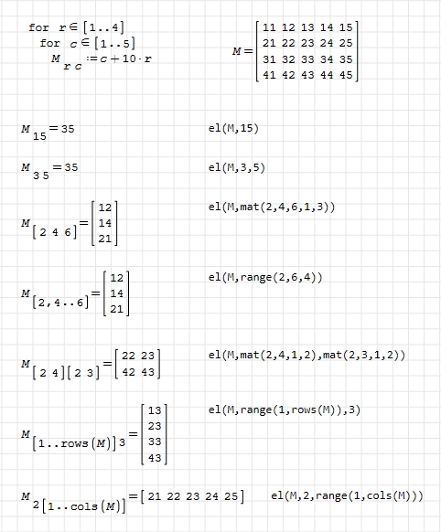

Hi. There are many different ways to access the elements of an array. This list is not exhaustive, and does not include the submatrix function.
M.sm (10,01 КиБ) скачан 1220 раз(а).

Thank you so much, especially for the examples (Jean, Davide, Razonar). It brightened up a lot of problems for me regarding matrices. Once again, thank you very much. One more thing, how do you write the range of elements in an array? Regards Adam
Your question is not clear w/o an example.
If not confidential, please attach the document.
Attached, a typical example @ the red arrow.
Cheers ... Jean.
2D Plot Multitrace [Gaussian] QUICK.sm (26,2 КиБ) скачан 1071 раз(а).
#11 Опубликовано: 30.09.2021 13:37:31
... One more thing, how do you write the range of elements in an array? Regards Adam
Use vector element
or matrix element
and then put a range (with 2 or 3 arguments) in the index placeholder
