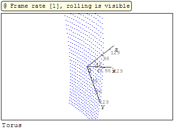

... it works, but it must be stopped dancing !
I figure some fixed Euler orientation must be applied ?

The calculation time will be greatly reduced, if the coordinates are represented as functions
x(t),y(t),z(t).

Thanks Ber7 for doctoring !
Orientation is acceptable, ~ 3 minutes visit.

Torus Rolling.gif ... updated

Good work, Jean. I extended the animation to the full cycle.

Surface represented by lines.
