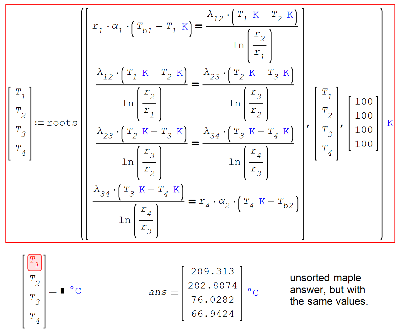

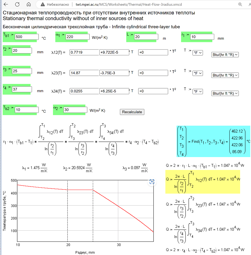

I would like to to sole the linear equations
F1=F2=f3=F4 with 4 unknowns T1, T2, T3 and T4
I can do it in Mathcad (given-find). but cannot in SMath ;-(
Help me please!
See please the Mathcad Calculation Server
http://twt.mpei.ac.ru/MCS/Worksheets/Thermal/Heat-Flow-3radius.xmcd
my SMath try in attach and
Lambda3.sm (434,36 КиБ) скачан 1573 раз(а).
the picture

Hi. Here two options for solve the system.
Lambda3.sm (452,05 КиБ) скачан 1582 раз(а).

I see Alvaro has beaten me to it, but here's my approach anyway.
Lambda3b.sm (470,18 КиБ) скачан 1621 раз(а).

My solution in attach
Lambda3.sm (265,4 КиБ) скачан 1601 раз(а).
