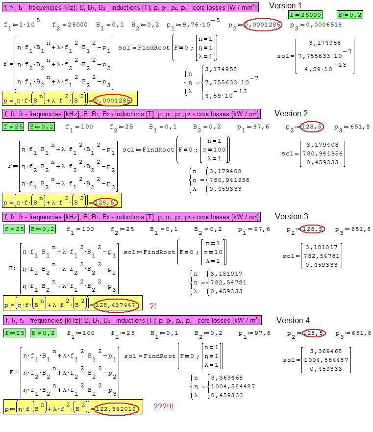

In attachment I intend to do a comparative study between solving the equation system using different units of measure. The first variant is the one already previously analyzed, with the measurement units dictated by practical considerations - [Hz] for frequencies, [T] for inductions and [W / mm3] for specific losses in the magnetic core. The following three variants correspond to the set of measuring units - [kHz] for frequencies, [T] for inductions and [kW / m3], used in ferrite cores producers data sheets. It is seen that depending on the set of three initial data, the result of the calculation is altered in variants 3 and 4. I also responded to Radovan's request to try to use different measurement units in order to avoid the zero convergence of the solutions for the variables η si λ. It can be seen that the use of this set of units of measure has advantages over the other. Considering the very wide range of ferrite cores currently produced, it is very likely that in some cases the calculation will yield vague results.
On the other hand, in connection with Radovan's fear that the use of very small subunits can affect the calculation, I think it is unreasonable. I made a SMath spreadsheet to see what result returns my program to 1/10^308. It was 10^-308. So in numerical representation, the program can distinguish between extremely close to zero results. By comparison, MathCAD has set the ∞ (infinite) level of 10^307. At the same time, however close to zero, the result does not in any way affect my initial values ​​set for the variables. The difference between the value returned by calculating of two variables, and their initial value, will always be less than the unit. For the value of exponent n, in practice we find values ​​of the order of the result from this calculation. So it seems to me that the advantage of the first option is obvious. Otherwise, all the best.

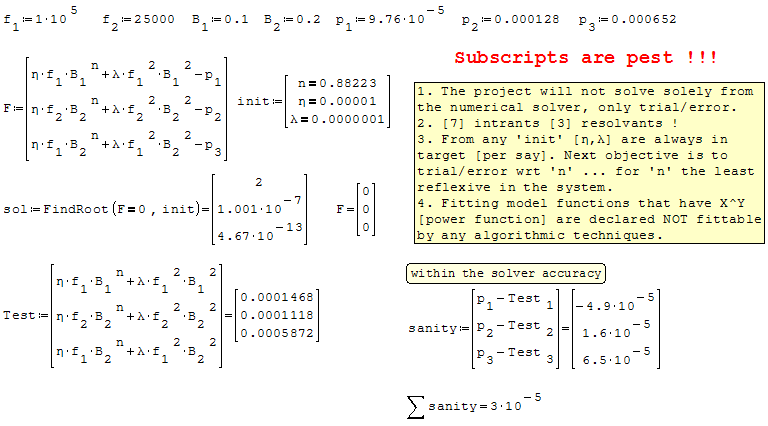

Up to this point, the project is brute force solved in the attached.
It could be refined from there by finishing outside of the solver.
It might be possible to manually optimized [η,λ] and let 'n=2',
this can't be predicted ... you may have to play [n,η,λ].
Could this finishing be done done automatically ?
Answer is NO ... why ? because of the X^Y power function involved.
Under the hood, X^Y is a combination exp(,), ln(,)
Can't help more, from this lecture. Lot more difficult/impossible
projects were done, well done from patience.
FindRootsRefexive.sm (15,03 КиБ) скачан 1218 раз(а).

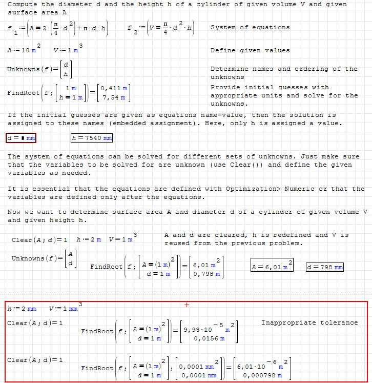

FindRoot() internally converts the numbers to base units (meter). The default tolerance of 0.0001 for variable and function is to be interpreted in the base unit of the given quantity.
In the first example with volume and height being close to unity in base units, the default tolerance is appropriate.
If the dimensions are scaled by factor 0.001 (mm instead of m) then the tolerance is nearly of the same magnitude as the variable. The result is complete rubbish. The problem is fixed by adjustment of the tolerances.
