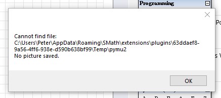

I'm getting the following error when saving a sheet
i'm using Version 1.0 (build 8151)
I've tried disabling various extensions but its still happening
Any help will be much appreciated

The error message seems related to something in the ImageEditRegion plugin
<ProjectGuid>{63DDAEF8-9A56-4FF6-938E-D590B638BF99}</ProjectGuid>

Thanks Davide,
I just disabled ImageRegion plugin and the error disappeared when i saved the sheet
Overlord - thanks for your answer
