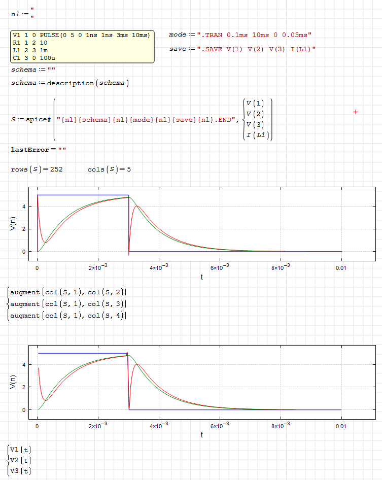

spice#-tran-example01.sm (10,7 КиБ) скачан 1198 раз(а).
Отредактировано 12.09.2025 17:03:55

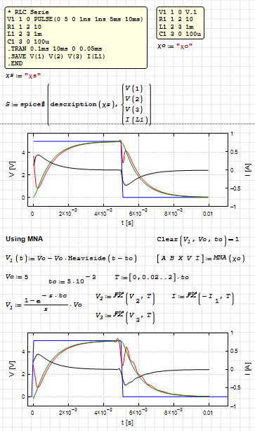

Hi. Using MNA method
spice# and MNA v2.sm (653,28 КиБ) скачан 1205 раз(а).

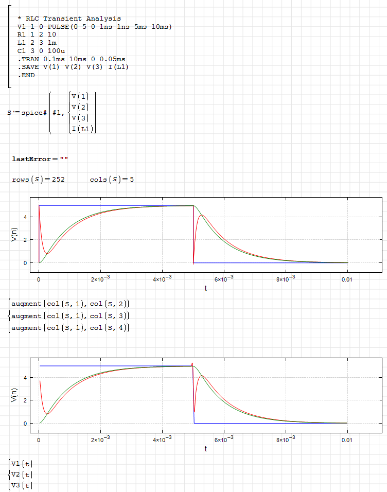

1 555 сообщений из 1 867 понравились пользователям.
spice#-tran-example02.sm (11,84 КиБ) скачан 1197 раз(а).

- Automatic Interpolation Function Generation.
spice#-tran-example03.sm (11,78 КиБ) скачан 1216 раз(а).

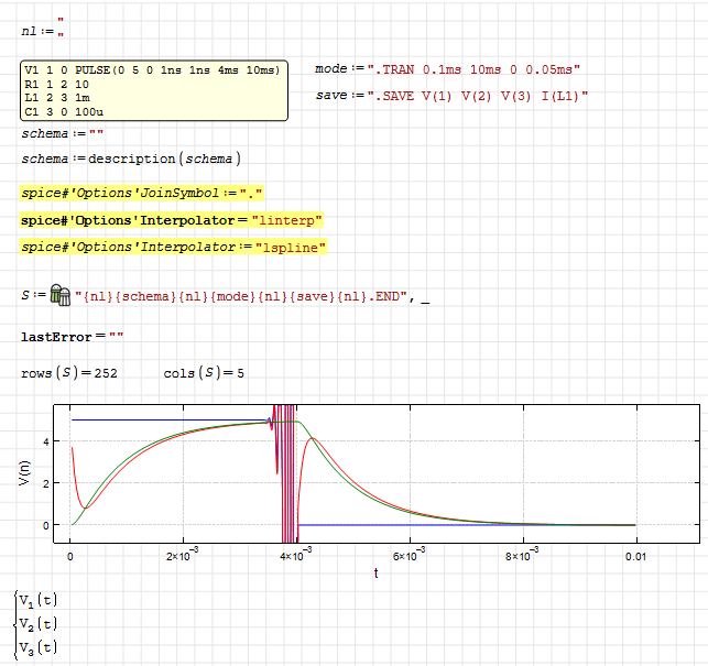

Changes:
- Refined Glyph Rendering;
- Added "spice#'Options'Interpolator" Operand.

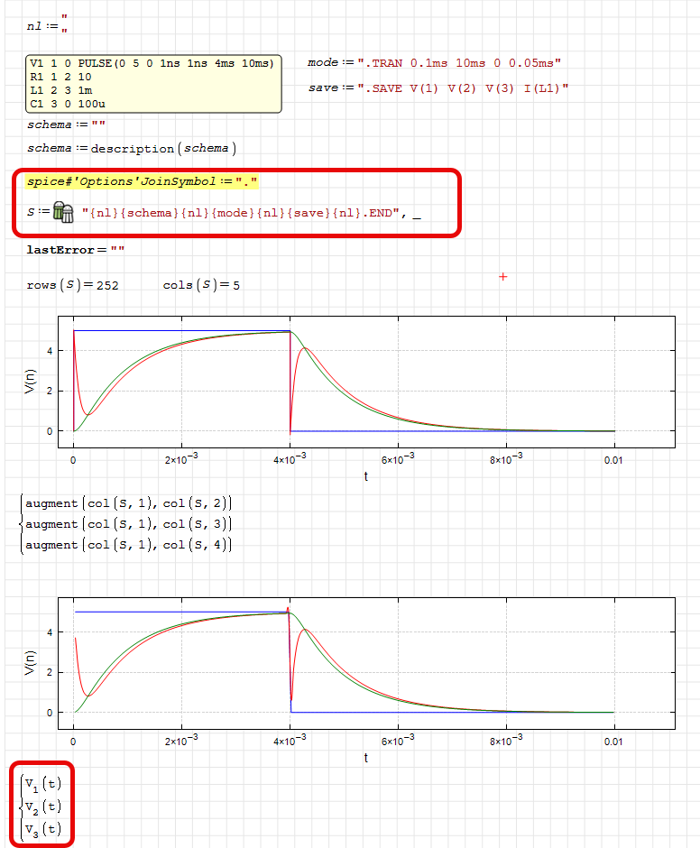

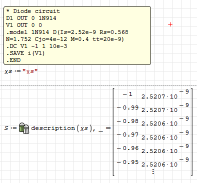

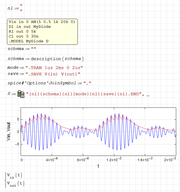

Hi Viacheslav. Great work, congratulations. Some questions:
I was able to introduce an ampop, which is a fairly theoretical model without many physical parameters. How did you introduce the diode model?
Is it possible to import ltspice models more or less automatically?
Another question: how could V1, V2, and V3 be graphed in your 3DPlot plugin? The CreateSpace function is new, isn't it? Do you have examples of how to use it? Generally, these graphs can't be created in simulators, and the data must be exported to MATLAB or other similar software.

I can tell you how to proceed, i.e. the algorithm for setting the problem.
If you want to simulate the scheme, then you need an example. Nowadays, in the programming world, it is common to accompany source texts with tests. These tests, as a rule, cover many typical tasks.
You need to find these texts, see the link below. Then introduce Gemini to the matter so that he can help create an adequate syntax. I simply throw the test sources into the chat as an example and say what I need.
Not at the moment, but I can make it so that it will be possible. I don't have enough time to finish this plugin, as it is a bit more complicated than X-Y Plot.
Yes, CreateSpace() is a new function, I asked Gemini to make it, but I haven't used it yet. The plugin does not support the data format returned by this function.

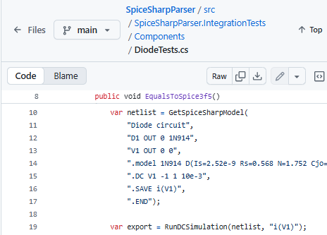

Hi Viacheslav. Thanks, the link you provide shows how to simulate components, for example, a diode:
