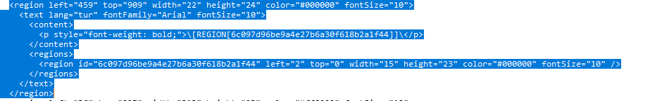

You can check smath files with a text editor.
An empty region between lines 520-530 was causing force crash.
Could you please check and inform if this works?

These are lines between 520-530.Which line creates the bug? In case, I will encounter this situation again in future, maybe I will be able to fix it myself.

Culprit is occasionaly lines contain >\[REGION[xxxxxxxx]]\.
They usually have some context you did enter.
Some title, some text, an image, etc.
But as you can see in this, it is empty.
I look for them at first, then others.
Don't delete every REGION containing regions.
Don't forget to backup your file too.
Even it is not opening.
