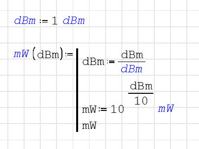

Any hints on how to go about setting up a sutom unit dBm decibel with respect to milliwatt
x dBm = 10^(x/10)mW
x dBm = 10^(x/10)mW
Here is a possible solution to your problem. Translating between dBm and mW. There is no simple relation between these units like Unit1=k*Unit2 (k = constant) and we have to use functions in this case.
Given functions are defined as 'dBm(.. and 'mW(... in order to see them as units (in blue color).
x dBm = 10^(x/10)mW
Can this be defined so that dBm(2 mW) = 3.01, and mW(3 dBm) = 2 mW, with units inside both function calls?
