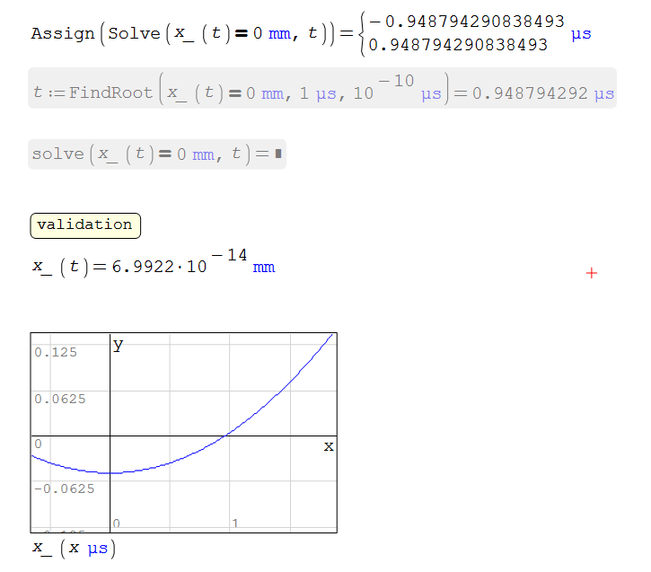

Hi Elis02,
Native solve() is nota robust solver, so it's convenient use functions as Solve() from Maxima plugin or FindRoot() from Non Linear Solvers plugin.
You need provide a value to x(t) for asking for a value of t that satisfies the equation, in the form "x(t)=k, t" where k is the value you expect obtain when replace for t:
Best,

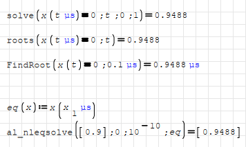

#3 Опубликовано: 02.11.2023 00:09:46
599 сообщений из 1 380 понравились пользователям.
Numeric solvers don't like units.
Either don't use them or add units to solvers.
Entering a range/interval will help for solve().
Findroot() won't need unit addition btw.
test_s_math_solved.sm (12,16 КиБ) скачан 1411 раз(а).
Oscar Campo 02.11.2023 00:13:00, NDTM Amarasekera 02.11.2023 19:07:00

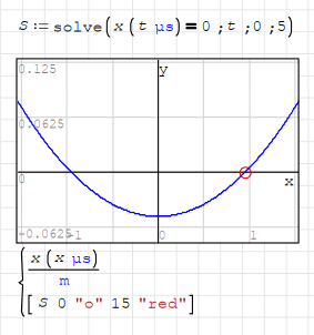

This is Jean's plot;

If you don't know, then don't say.
Your mistakes are harming this community.
Alvaro 03.11.2023 02:50:00, Oscar Campo 03.11.2023 05:24:00, NDTM Amarasekera 03.11.2023 09:00:00

Jean, look and learn. This is how you eliminate units.
Btw, why did you delete all your meaningless replies?
Can you see the problem Jean?
You forgot your unit conversions.
m_Ar and E1 needs magick numbers in your approach.
If you would capable to work with units, no coefficients needed.
Everything is simple, clean, easier to apprehend, much easier to manipulate with units.
Oscar Campo 03.11.2023 23:30:00, Alvaro 04.11.2023 00:16:00
