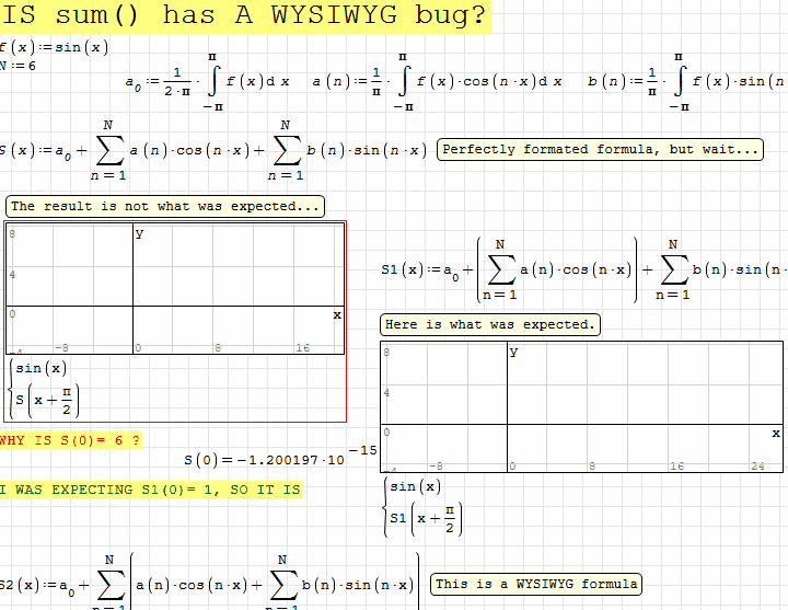

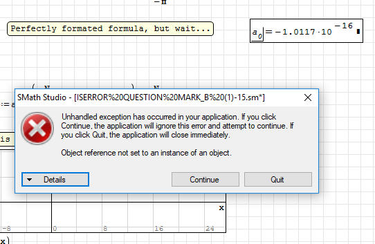

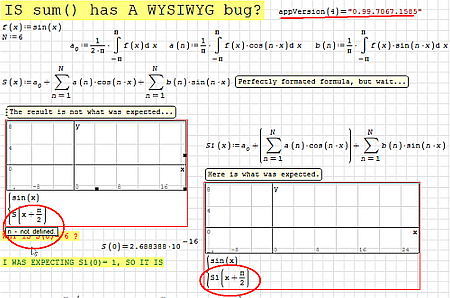

Some times it crashes when trying to evaluate some variables.
ISERROR QUESTION MARK_B (1).sm (18,72 КиБ) скачан 1492 раз(а).
ISERROR QUESTION MARK_Clean.sm (10,4 КиБ) скачан 1506 раз(а).

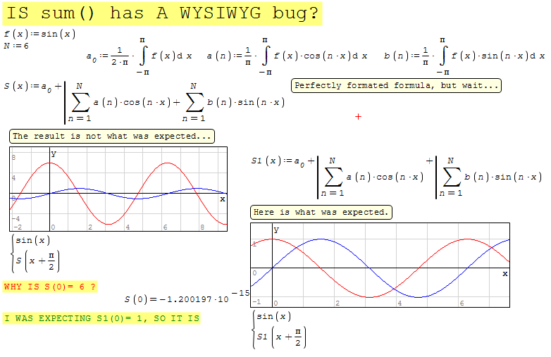

This problem with summation will come up here and there. It would be enough to put the summation terms inside a single line environment. This behaviour is present in SMath for quite a while. This is easy to forget, but it should not have crashed in those cases. The problem is how to remember this issue and overcome situations like this one.
WroteThank you Alvaro, you are right
Can't be more right ! Now you understand why I never updated.

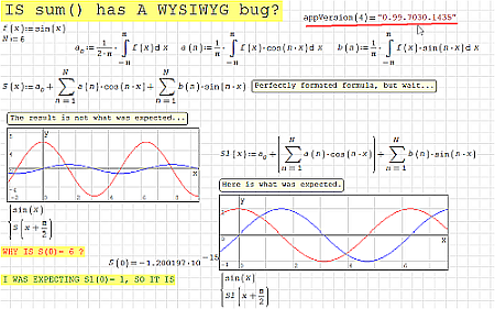

How do you know if it is simply a beta version bug ?

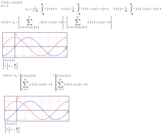

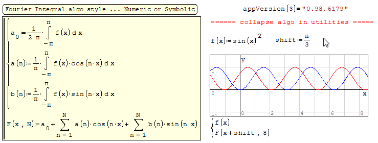

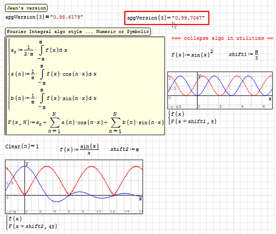

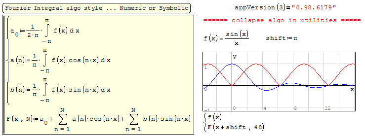

Try this Fourier-algo style.
Fourier Integral Algo Style.sm (7,66 КиБ) скачан 1444 раз(а).
But if included in line program, works for ever. My fft(,) ifft(,) work since day 1 [2015].
The free style Σ is not recognized by Smath kernel.
I have more than fft(,) ifft(,) like Simplex lot more involved works great within line.
I wish to read "Thanks Jean, doctored".

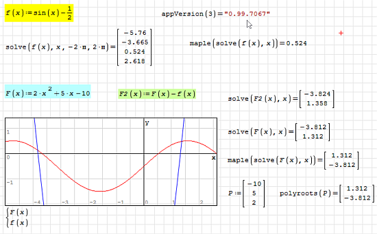

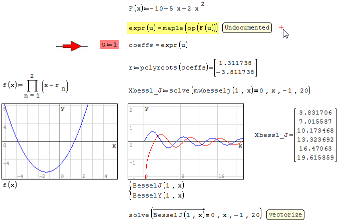

The attached sm file also crashes some times when inputs to Polyroots, solve, maple(solve)
are changed or adjusted.
Roots_Ex1.sm (16,06 КиБ) скачан 1415 раз(а).
I will try more variations and post if there is any crash.
Thank you you Radovan.
WroteThe attached sm file also crashes some times when inputs to Polyroots, solve, maple(solve)
That shouldn't happen, but maybe on latest beta.
1. Polynomials have unique Lagrange format [lot many books are wrong].
2. maple(op(F(u))) will save you manual steps and possible typo errors.
Maths eigenAll Companion.sm (62,14 КиБ) скачан 1407 раз(а).

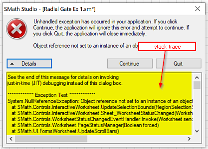

WrotePlease remember to copy and attach here the stack traces when you encounter such critical errors, especially if they are not easily reproducible like this.

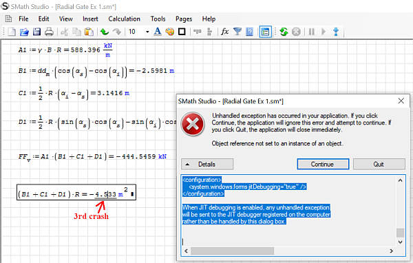

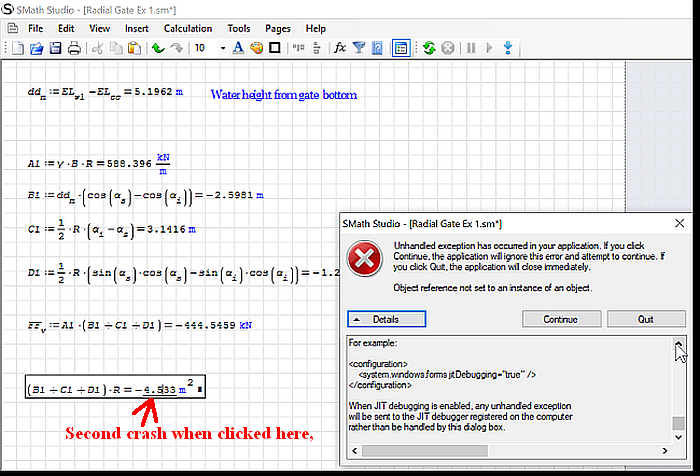

Even after a Clean Re-installation, crashes continued to occur on and off.
Attached sm file crashed when I was doing some changes to either default units,
or copying etc. (I'm not sure). Note where I clicked.
Radial Gate Ex 1.sm (194,77 КиБ) скачан 1377 раз(а).
WroteEven after a Clean Re-installation, crashes continued to occur on and off.

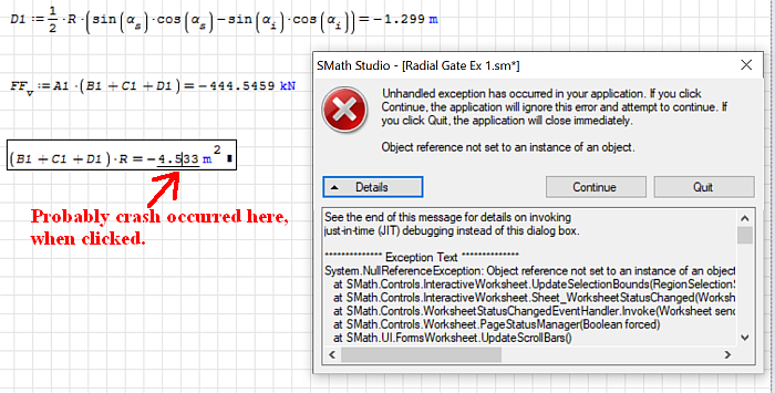

Second crash. BTW how do I create stack traces and copy?
Radial Gate Ex 1.sm (195,59 КиБ) скачан 1423 раз(а).
WroteBTW how do I create stack traces and copy?
Simply copy the text from the error window
You can paste in the following BBcodes if it is too long
[spoiler]my text goes here[/spoiler]
or
[code=markup]my text goes here[/code]
Third crash occurred, and the stack traces (in MS Word) attached.
Radial Gate Ex 1.sm (195,59 КиБ) скачан 1366 раз(а).
7067 3rd Crash-Stack Traces.docx (18,08 КиБ) скачан 870 раз(а).
