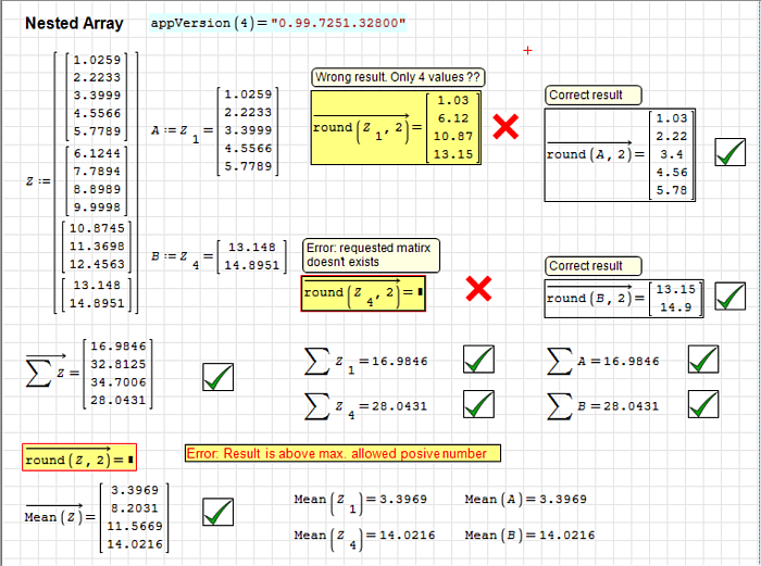

Observed errors with nested arrays as shown in SS 7251.

#4 Опубликовано: 12.01.2020 15:35:14
I think the observed behaviour matches the following hypothesis on how vectorize() operates:
- search for array-valued operators in the expression (before executing any part of the vectorized expression). in your case it is Z.
- Determine length of these operators. In your case length(Z)=4.
- If all non-scalar operators share the same length, then generate a loop for index = 1..length. Otherwise complain about length mismatch. In your case this iterates over the four sub-matrices.
- within the loop, apply the original expression, with the non-scalar expression replaced by the indexed one. In your case extraction of first element and subsequent rounding is applied to each of the four subvectors.
- return a vector with the stacked results of each iteration.
In the second case, the error results from failing to extract element number four from the last two vectors (having less than 4 elements).
The hypothesis doesn't, however, explain the last error "Result is above...".

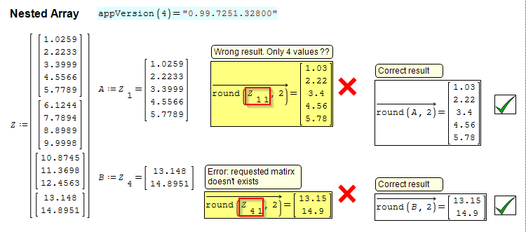

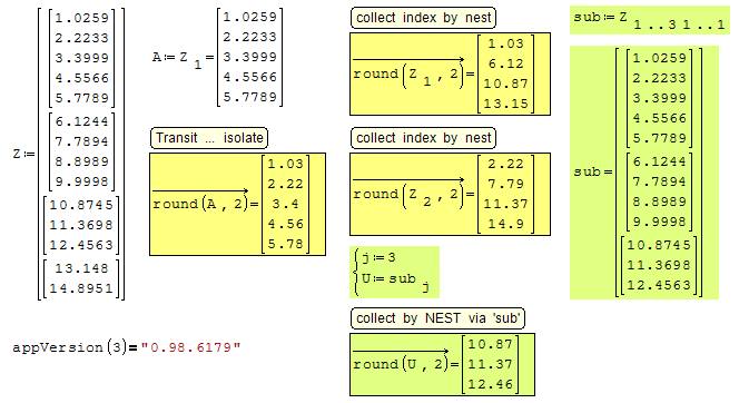

#5 Опубликовано: 12.01.2020 15:36:52
For this case short answer will be that we have to use both/all indexes for the nested arrays.
As Martin explained, we have to be careful about how the things are going on with vectorize operator.
Regarding the famous uninformative "Results is above max. allowed positive number." here is another example whit this error.
sergio 13.01.2020 08:00:00
#6 Опубликовано: 12.01.2020 15:56:22
Radovan, unfortunately your example isn't consistent with my hypothesis
Single and double index el(Z,1) and el(Z,1,1) both return exactly the same result (first submatrix) if applied on the canvas.
So there is no hint why to expect different results when applying vectorize().
Can the developers please shed some light on this?
Radovan Omorjan 12.01.2020 16:02:00

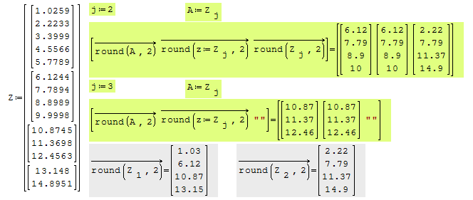

#7 Опубликовано: 12.01.2020 16:33:08
May be I have not properly understood the vectorize operator.
Thank you Jean.
Thank you as well NDTMA, very educative example.
You can have more otherwise ... Ah !
Vectorize Nest_Sub.sm (18,12 КиБ) скачан 1428 раз(а).
#8 Опубликовано: 12.01.2020 16:58:32
If you have red or not as demanded, IMHO: the bug is SS 7251.
Revisit the last attached Vectorize Nest_Sub.sm

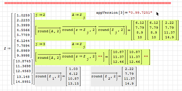

#9 Опубликовано: 12.01.2020 17:59:20
#10 Опубликовано: 13.01.2020 01:59:14
NDTM Amarasekera
NDTM Amarasekera
Originally Posted by: Jean Giraud [url=/forum/yaf_postsm60333_Vectorize-Errors-in-Nested-Arrays-in-SS-7251.aspx#post60333][/url]If you have red or not as demanded, IMHO: the bug is SS 7251.
Thank you Jean. No errors in 7251.
Also many thanks to Martin and Omorr for your comments.

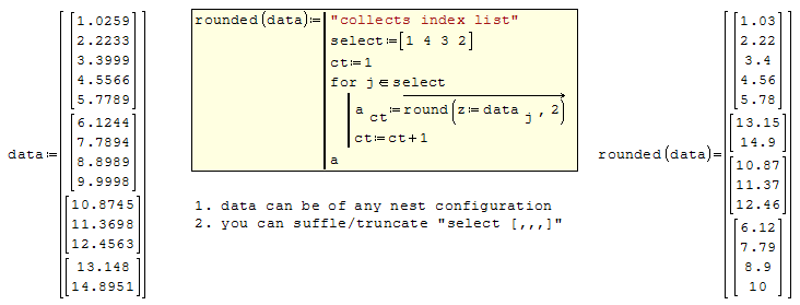

#11 Опубликовано: 13.01.2020 11:18:48
Hello Collab from so far away,
maybe, that's what you were after ?
Vectorize Nest_Sub.sm (23,18 КиБ) скачан 1327 раз(а).
#12 Опубликовано: 13.01.2020 14:32:29
NDTM Amarasekera
NDTM Amarasekera
Yes. I also did it using a traditional loop method.
But yours is more elegant.
Thanks.
