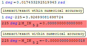

In a cam profile generation program, I perform some boolean operations with angular values (input in degrees).
I noticed some boolean operations fail due to a varying accuracy.
The file in attachment will clarify what I mean.
How can I make these values equal? Reduce the amount of significant numbers?
Thanks in advance for any feedback!
Kind regards,
Jan

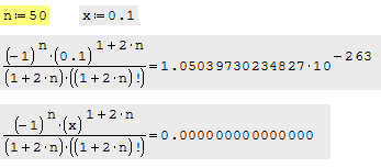

... differently puzzling: set n 49, 50

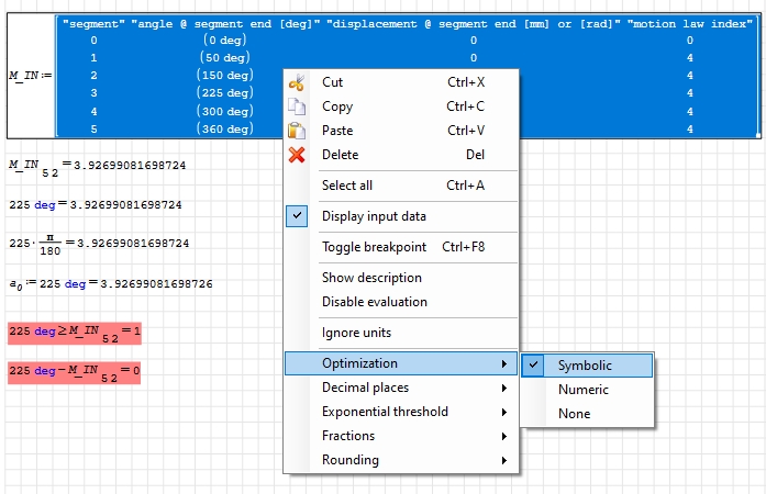

Choose symbolic optimization in the matrix definition.

Leave the main matrix numeric, explore Numeric/Symbolic in-situ
The two Boleans disagree ... IMHO, Numeric is the practical procedure.
