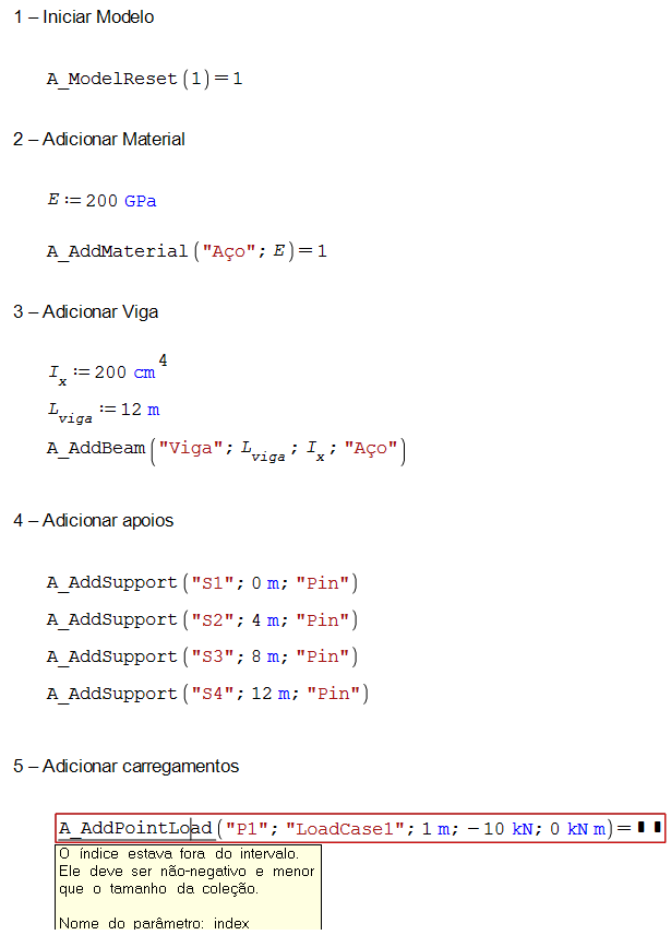

I have a question regarding the use of the plugin FEBeam. I downloaded some examples given by the plugin's creator, JC Mendonza, but couldn't reproduce it. When i try to add a point load, the following message(Portuguese) appears:
"O índice está fora do intervalo. Ele deve ser não-negativo e menor que o tamanho da coleção. Nome do parâmetro: index", which translates to:
"The index is outside the interval. It must be non-negative and smaller than the collection size. Parameter name: index".
I don't understand why this is occurring, since the load is applied at a positive position that is smaller than the beam length.
Could someone help me with this?
Thanks in advance.

#3 Опубликовано: 19.04.2024 01:44:49
Jose Carlo Mendoza
Jose Carlo Mendoza
7 сообщений из 14 понравились пользователям.
Thanks in advance.
Looking at the snapshot, the error is because no beam has been created in the code. The functions, "A_AddBeam" and "A_AddSupport" need to run by evaluating them. The function should return 1, which means "true" in the code behind that it has been executed. Put equals in the formulas for example: A_AddBeam(_,_,_,_) = 1. Though not sure why smath does not evaluate if you dont put "=".
