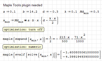

Hi Tiago. This is one way.
#6 Опубликовано: 09.12.2021 12:56:18

I need this display after the expand
https://ibb.co/Sfmj1jz

not the end result but what is between expand and solve
#10 Опубликовано: 09.12.2021 17:45:02
The polynomial coefficients?

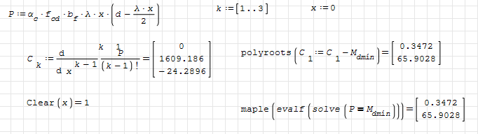

sorry for my ignorance i didn't understand your answers, and because i need to show the students step by step how to perform the calculations

I need the blue rectangle to be the same as the yellow one, is this possible?
https://ibb.co/2n6Np5C
Not possible to easily write all those functions in one line.
It can be done with serious alterations but shall not be practical.
I posted something similar to another user. But again, I wouldn't use it.
Just write functions and solves in multiple lines.
