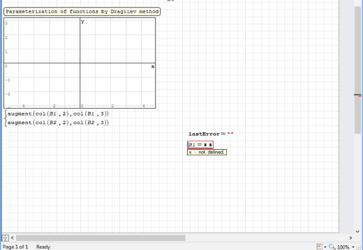

The error in the graph is that x is not defined.
What causes this error?
In the graphs published by you it is seen that graphs correctly.

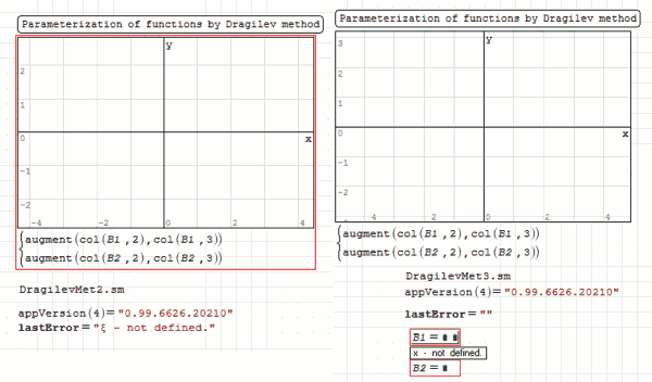

Attached drawing of the errors.
Hello Jean, your files worked perfectly.
Carlos

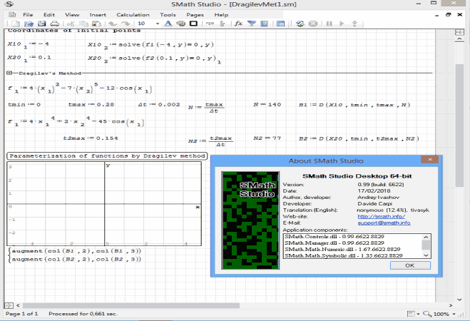

It's because a problem with rkfixed routine in your environment. Try to download this, or use it in the cloud: DM_RK

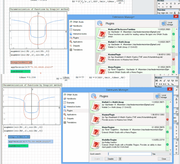

Thanks for your answer, but I found the fault.
The interference is caused by the Maxima Plugin,
by disabling it, the file works correctly.
Carlos
