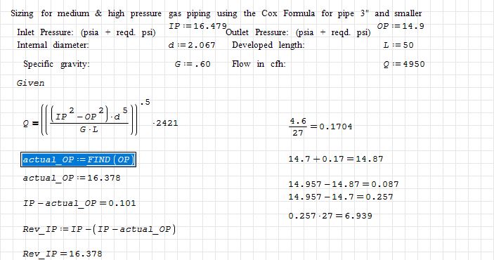

Good morning Experts,
I have landed myself into a new IT/troubleshooting position at a new company and one of my first tasks is to resolve a many year long issue.
We have a very old laptop that contains two formulas for calculating Low pressure and High Pressure drops in Gas piping for construction work.
we have been using a very old version of mathcad and while surfing the web I came across Smath and i believe i should be able to perform the same executions with this software.
I tried to open the existing files into Smath but the equation no longer solves.
I believe my issue is finding the corresponding function from Mathcad to Smath.
The Mathcad function I am looking to for in Smath is "Find"
Find = Returns the values of var1, var2, ...., that solve a system of equations in a solve block. returns a scalar if there is only one argument, otherwise returns a vector of answers.
i am willing to send the files and share screenshots.
Hope to hear from the web soon!

Jean,
we are trying to solve for OP and i have another one where we are trying to solve for PD but if i can manage to figure out how to fix one of them i think i should be able to get the Low pressure to work as well
GASHP.sm (10,57 КиБ) скачан 1207 раз(а).

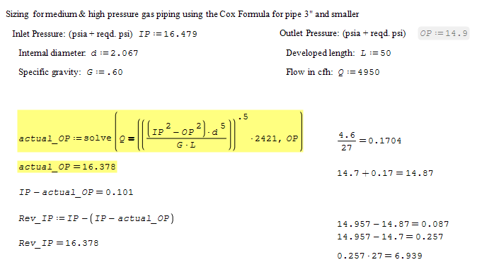

Your problem seems to be quite simple and mentioned here on the Forum many times (maybe to many...).
Using solve()
GASHP-cor.sm (9,94 КиБ) скачан 1163 раз(а).
Using solve()
