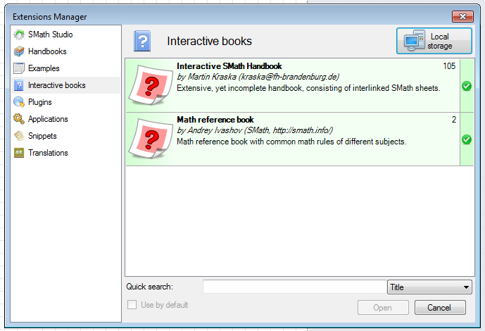

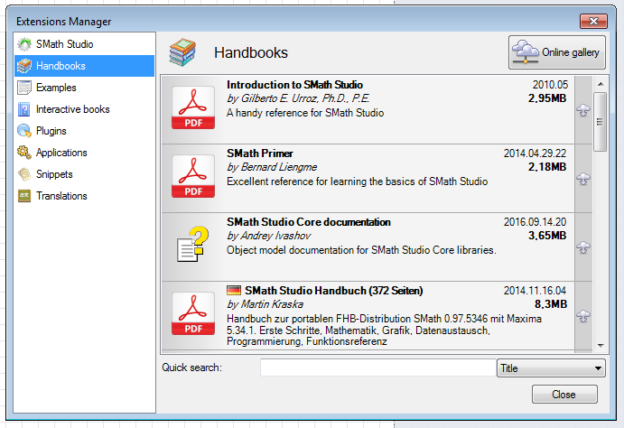

Hello [userlink]Sjoerd[/userlink], welcome to our community
You can find several tutorials in the wiki, as well as in the extensions manager (Tool > Plugins > Handbooks [and/or] Interactive books - change the source from Local storage to Online Gallery)

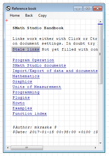

Interactive books, once flagged to be used as default, will be available through Help > Reference book
