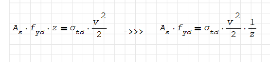

how can i do like this? - Сообщения

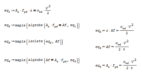

Hi. You can use maple's algsubs function (algebraic substitution)

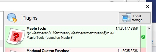

Maple is a Plugin you can install:
To expand off of [USERLINK]Razonar[/USERLINK]'s post; 🍁Maple has several functions, another ̶o̶n̶e function you can use is "solve": you can evaluate the equation symbolically:
I don't know how to isolate (2) variables, thus I am only able to isolate the (1) variable in this situation.
As a final note: instead of relying on SMath to isolate the term everytime you open your SMath Worksheet, you may want to copy/paste the result and use that math directly. There was another thread (i.e., https://en.smath.com/forum/yaf_postst23461_how-can-i-simplified-result.aspx) where Maple provided a different way to isolate the variable in question.
