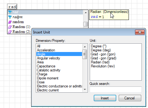

Part of this can be mitigated by re-declaring the units in a custom xml file.
<units>
<property dimension="613" title="Angle" lang:ger="Winkel">
<add factor="1" system="All" id="294">
<synonym name="rad" lang:rus="рад" />
</add>
However, not really. The selector box shows the new category, but the dynamic assistant does not.
![2017-03-01 18_25_14-SMath Studio 0.98.6179 - [Page1_].png](/ru-RU/files/Download/5Qy35d/2017-03-01-18_25_14-SMath-Studio-0.98.6179---[Page1_].png)
