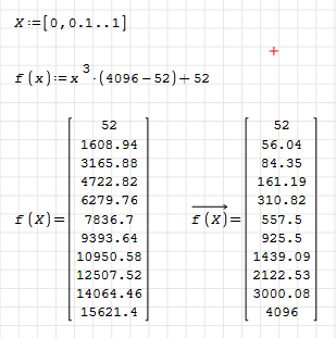

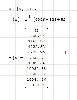

Hi, Is there a reason why I'm getting those obviously wrong results?
#2 Опубликовано: 28.09.2023 12:35:00
1 111 сообщений из 1 787 понравились пользователям.
Hi. Looks like a bug in the "implicit scalar expansion" according to the expression in matlab for vectorization. Use explicit SMath's vectorize as workaround.

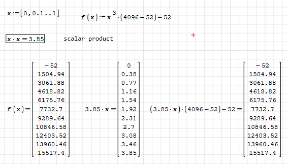

Or not. It depends on how x^3 is interpreted. If the usual recursive definition is used, x^3 = (x^2)*x, then x^2 = x*x would be a dot product, while x^3 = (x*x) *x would be the product of a scalar times a vector, and the SMath result would be correct, although perhaps not the 'expected' one.
