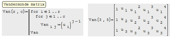

is there an inline-variant of the loop mentioned in the picture,
because when i try to add an index to the function w(x) it throws a syntax error.

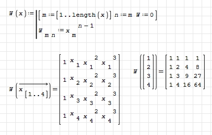

Hi Crang. This could be an option
VandermondeMatrix.sm (6,99 КиБ) скачан 1203 раз(а).
