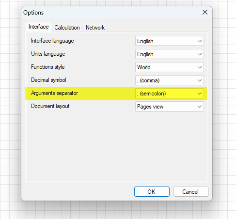

#2 Опубликовано: 20.03.2025 22:16:41
1 440 сообщений из 2 929 понравились пользователям.
To add conditions, inside one of the if placeholders (the black squares) type the argument separator (usually is the semicolon ; or the comma , ).
Press it multiple times to add multiple if/else conditions. Use the backspace to remove cases.
