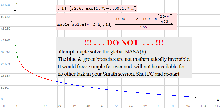

Inversing a function, i.e: solving a function is often difficult or not possible.
Many pure functions or like pure functions will root-plot on the canvas [Mach].
Gaussian functions will need be specified piece wise.
NASA(h) will show something on the canvas as demonstrated. The three branches
generate some complex solutions, the complex sols won't plot thus the blanks.
1. The red branch is sufficiently pure to plot almost continuous.
2. The blue branch suffers more in the low range.
3. The green branch plays hide and show game ... but willing.
The discrete solver is the alternative, but you don't have an exportable
function-solution ... interpolate the discrete data solution.
If you have better alternative ... welcome ! Jean

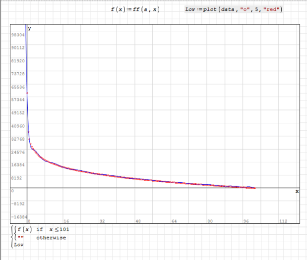

Thanks Carlos ... will try fit in the low commercial range.
Up until now, J_Frac reconciliation in two segments.
Inst_ISA [km_kPa] solve NASA Reconciliate.sm (52,18 КиБ) скачан 1100 раз(а).
WroteUp until now, J_Frac reconciliation in two segments.
... refreshed a bit for 0 error @ sea level.
Inst_ISA [km_kPa] solve NASA Reconciliate.sm (52,31 КиБ) скачан 1091 раз(а).
