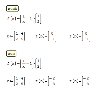

I just wanted to get into attention this thread once more. There were problems of rather different results using different optimization and different solvers. Those problems still remained unexplained.
Just look at the picture and try the attached file. Changing the symbolic/numeric/none optimization and using/not using eval() for the yellow regions, there will be different results. This time, we will get different results - sometimes scalars, sometimes vectors.
Primer63w_again.sm (36,71 КиБ) скачан 1509 раз(а).

Here is an minimal example showing the problem mentioned above.

Or this one
EDIT: This is not good by all means. Something has to be done about it.

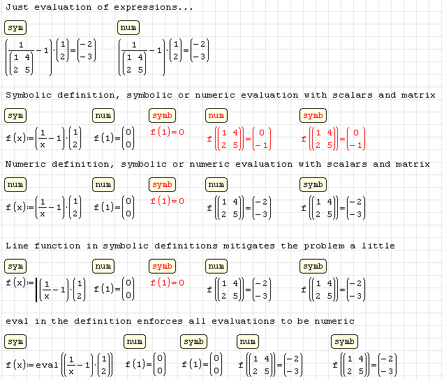

The whole disussion just illustrates the survival rules
"Never trust symbolic evaluation"
"Never use symbolic optimization in function definitions"
Sometimes eval() or line() may save the day.

The reason for the problem is the type-unawareness of the symbolic optimization, as was already discussed in the Transpose function bug topic.
Thus, what can be done? When SMath does symbolic optimizations, certain assumptions are made (just like operators being scalar). Strictly taken, you would need to add a type checking instruction to any definition that is optimized under such assumptions. Alternatively you could block invalid optimizations by providing type information. Function arguments that are to assume matrix values would require to be marked as such. Otherwise matrix arguments are to be refused by the function.
