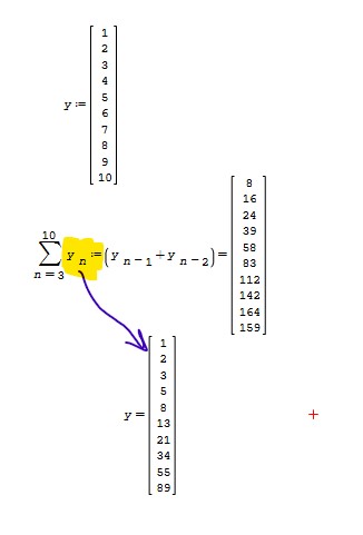

For example, I used the summation to modify the elements of variable 'y' to reference the previous variables of 'y' and thus created a Fibonacci Sequence in fractions of a second:
Hope this is of help,
