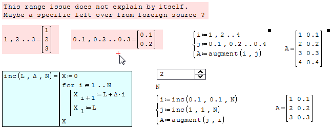

Hi. Is that ok?
range_issue.sm (2,74 КиБ) скачан 1308 раз(а).

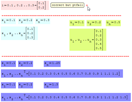

Hi. Is that ok?
Certainly NOT for use.
range_issue(1).sm (8,12 КиБ) скачан 1322 раз(а).

Is that ok ?[/quote
... doctored otherwise from undefined 'zero' in Smath.
rangeissueDoctored.PNG]

Second argument isn't guaranteed in results, as reported in the function description. The reason (as shown by Jean) is that the calculated increment value and/or the results might introduce a small error. We might see if can be somehow improved, though.
Thanks Davide ... Reconciliation as demonstrated.
Utilities Discrete ALL [Read 1rst].sm (9,62 КиБ) скачан 1216 раз(а).
