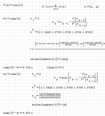

Hi Jon,
by default SMath evaluate simbolically. In short, this means that if you have (f.e.) X=a+b+c=A, the expression (a+b+c) is stored and then evaluated on request; so if you have Y=d+e=B and you want to calculate X+Y, SMath returns a+b+c+d+e, not A+B. This minimize the error propagation.
When you use eval(), the calculation of a+b+c is performed and the numerical result (A) is stored.
When you have loops or complex calculation, the expression terms might stack in a very long equation. If you have a vector or a matrix, each element might contains a lot of them.
When the complexity arise, since an evaluation requires to retrieve each element from the memory, replace it, and perform the actual calculations, it might be useful to perform an eval() (in some functions the result is forced to be a numerical evalution, so the performance improvement might vary).

Hi. This example can illustrate what Davide says.

As a rule of thumb, you can/should write everything without eval() and introduce some only if the evaluation as a whole is noticeably slow; the threshold is on you, I think 5 to 10 seconds is where you should start to investigate if something could be improved, looking at the regions with persistent green border (those under evaluation) and their contributors.
Too many eval() are useless and they make the worksheet less readable, though in this case you might use a user-defined overload one-character function to mitigate it (something like ''(x):eval(x) or \0024\(x):eval(x) ).

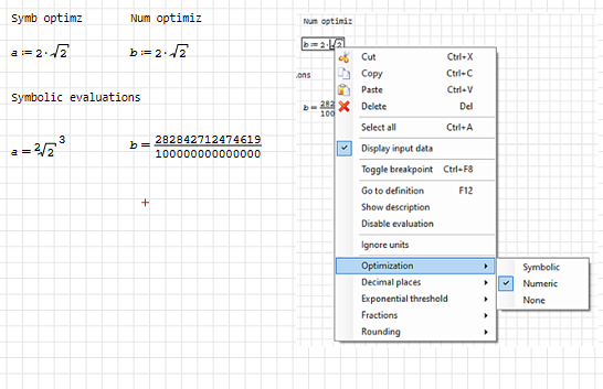

Wrote... think that an 'auto-eval' mode would be a useful feature, but maybe this is not possible to integrate into the Smath structure. ...
Hi. There is something like that, the Optimization/Numeric option from the contextual menu. You can also select all expressions with Ctrl-A and choose that option for the entire worksheet.
num-optimiz.sm (71,39 КиБ) скачан 1630 раз(а).
