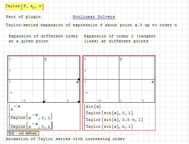

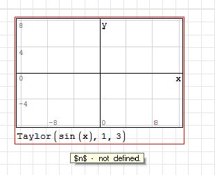

I found that if I try to draw a function in 2d plot using Taylor function, then it shows the error "$n$-not defined.
Radovan Omorjan 15.10.2019 05:08:00
#2 Опубликовано: 15.10.2019 05:11:12
From the Martin's Handbook as well
#3 Опубликовано: 15.10.2019 14:29:02
Confirmed: it stopped working between SS 5346 SS 6179

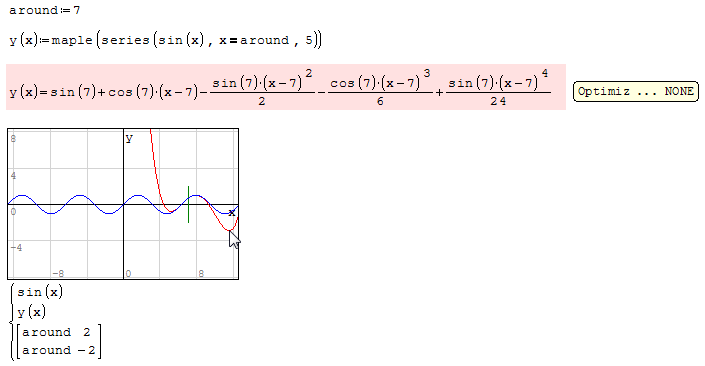

#5 Опубликовано: 15.10.2019 19:52:16
... more didactic [IMHO, of no interest].
Maple series.sm (36,51 КиБ) скачан 1174 раз(а).
