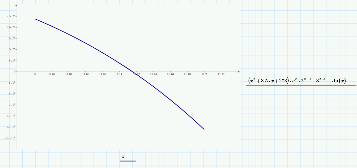

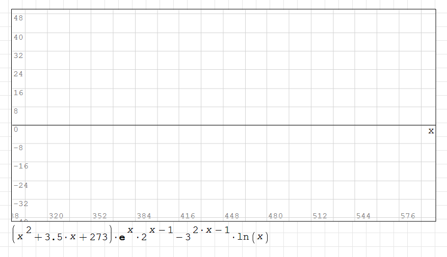

Why smath cannot plot this?
Smath
Mathcad

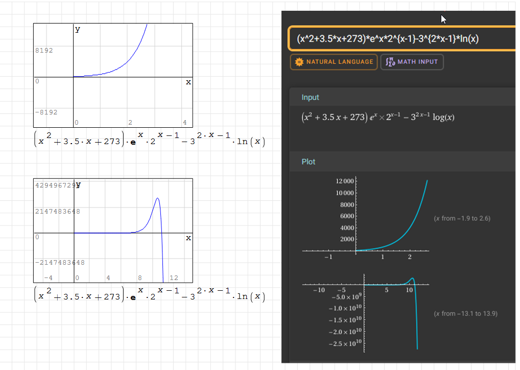

For me it plots like in wolfram. There might be some hidden brackets?
(your viewport is out of the plot area, so it doesn't show anything)
edit: added both small and large plot ranges
f(2).sm (36,41 КиБ) скачан 1465 раз(а).
sergio 23.12.2024 21:37:00

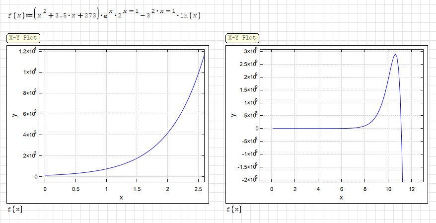

I agree. The integrated plots were primarly intended to be fast sketch plots, hence the poor features. We can hope in future they will be improved.
As for now, for advanced plots, I reccomend the XY plot plugin made by uni.
overlord 24.12.2024 00:30:00
#5 Опубликовано: 24.12.2024 00:52:55
Easily created with X-Y Plot by manually range input.
