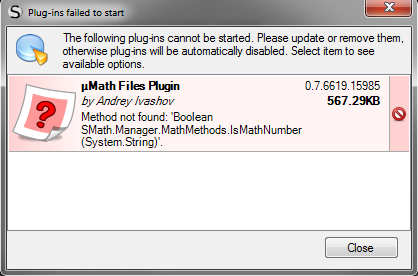

WroteuMath Files Plugin appears to be broken with new release.
Thank you! Fixed and new plug-in version uploaded.

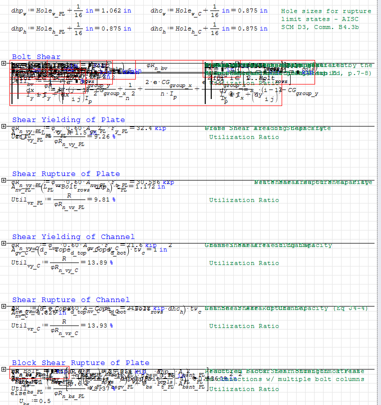

WroteArea controls seem to have been adversely affected with this build.
Please could you send a file to me by e-mail to fix? I cannot reproduce this issue on any of my worksheets.
In my case, when the sheet is opened, the problem does not exist but after saving the sheet, after closing it and finally reopening, problems with the collapsed areas occur.
C6 Channel Shear Tab.sm (228,91 КиБ) скачан 1627 раз(а).
Do you have the initial version?
WroteI experienced problems similar to those of Jason.
Sergio, seems this is very important issue. And bug is in saving logic.
Please could you provide any file which gives this error on save?
Thanks in advance!
Jason
Channel Shear Tab.sm (228,88 КиБ) скачан 1576 раз(а).
I've reproduced this issue and it is introduced exactly in 0.99.6646.
I'm working to figure out the reason and fix it asap.

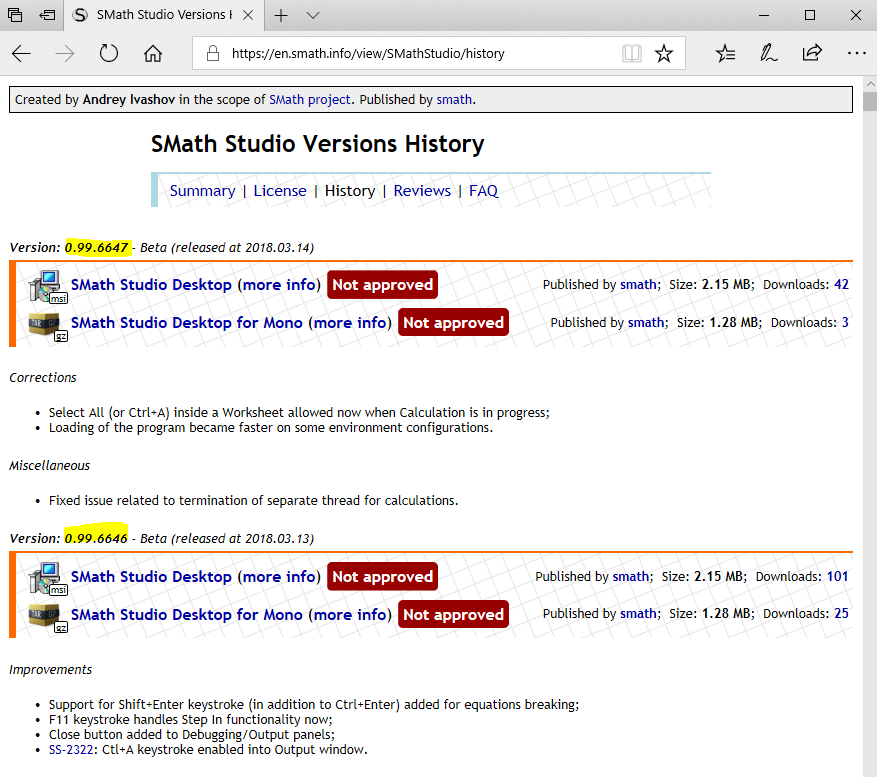

The following SMath Studio nightly builds are marked as NOT APPROVED and will not be suggested to download to anyone anymore: 0.99.6646, 0.99.6647!
Thank you very much for the report and your help!
