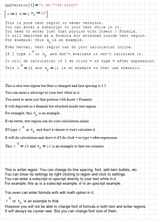

Hello to everybody,
I am new with this software. I want to know about the possibility to define subscripts in text, not in formulas. Aditionally, I want to do are class notes for the students: initially, I want to define the theory and then some examples about that. Is it possible to write formulas and that they won't be calculated?

Hello, to complement the question, in my opinion Smath has a great potential for their use as class notes to students. If text options could be improved (formula definitions and others things) it could be a very good option, not only in Maths and Physics classes but also in Engineering.

Maybe usage of text region as it is shown in example below can satisfy your needs.
If you install Writer Region plugin you will find out it has more capabilities.
