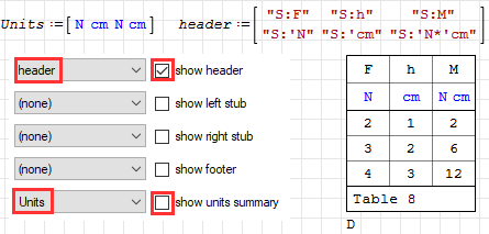

#4 Опубликовано: 20.10.2023 19:56:26
Please, is it possible to insert one or more formatted labels into a matrix or into a table ?
Into a Table, don't know. Into a matrix YES..
1. Insert the Formatted Label, absent of title to see the decorative icon
2. Insert 1 x 3 matrix ... top/bottom 0,0
3. Brush over blue style the Formatted Label
4. copy/paste in the black center place holder.
In my example document, result Formatted Label evaluates.
Consequently, I have my numerical result of Convolution example.

#6 Опубликовано: 20.10.2023 23:10:54
Bonjour Jean,
Salut Ioan from the old days.
Please, confirm it works.
Take care ... Jean.
Image Formatted LABEL INSERT MATRIX.sm (22,52 КиБ) скачан 1414 раз(а).
