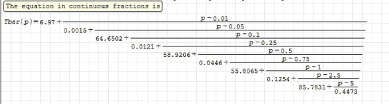

This example is an automation of the Thiele function
published by Jean in the "Utilities Pts logpts Application" sheet

WroteThis example is an automation of the Thiele function
... refreshed a bit, a note added.
Superb, the piece of automated interpolation.
Thanks Carlos ... Jean

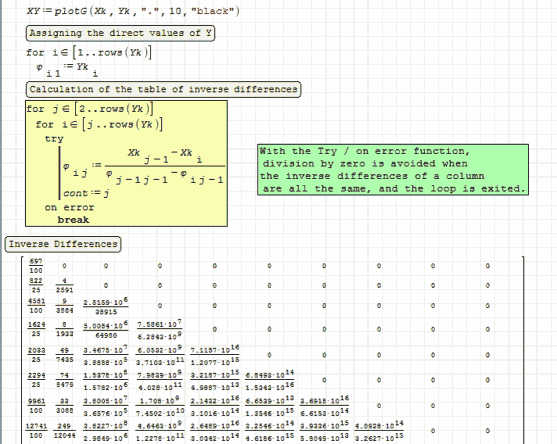

Hello Jean
Updated version of Interpolation using the Thiele algorithm in cuntinuous fractions.
It includes the calculation of the inverse differences φ [x0, ..., xi], obtained from the values in the known points
Rounding the values of the inverse differences for the purpose of presenting the equation to make it shorter
Thiele_Automatic_Jean_CBG_R1.sm (69,59 КиБ) скачан 1310 раз(а).
