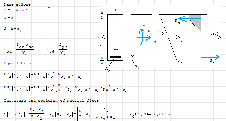

In my previous topic I was struggling with getting properly built equations.
Right now, I have prepared document, where I am looking for two unknows, basing on set of two equations. Can anyone take a look and help me to solve it? (attachment)

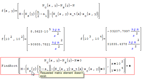

#5 Опубликовано: 07.03.2017 18:57:38
Bad chances for a solution
2017-03-07 22_55_15-SMath Studio 0.98.6179 - [Strain_stress%20-%20SMath%20forum_mkraska%20simplif.sm.png

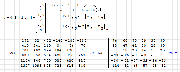

#10 Опубликовано: 08.03.2017 14:45:49
I tried to setup the procedure in an slightly alternative way and tried several ways to represent the stress-strain curves (cases, linterp, abs)
There may be errors in the equations, but this is just how far I got, just to understand the mechanical problem.
The equations fail to be solved using roots(). Also Davides functions can't handle the integration variable, which unfortunately is blamed to be unknown.
I guess, an option would be to provide analytical expressions for the stress resultant and it's centroid. For trapezoidal shapes that should be pretty easy.
Reinforced-beam.sm (311,79 КиБ) скачан 1358 раз(а).

#11 Опубликовано: 09.03.2017 05:56:22
mdominiak
mdominiak
0 сообщений из 23 понравились пользователям.
It is essential and missing calculating the resisting moment (but should not be a problem). Why do you want to simultaneously solve the two equations of equilibrium, given that it only takes one to determine the neutral axis?
It also lacks the management of the units I remember I gave it some thought.
At this moment I want to solve equation, where I have given design moment (M) and axial force (N). The results I want to get are strains in both concrete and steel.
You are right that I am not calculating resisting moment right now.
The next step will be to get all possible moments (M) and forces (N), where strains are given to prepare so called interaction diagram N/M. Result below.
The formulea is true only when Eps.1>=Eps.yd=fyd/Es and Eps.2>=Eps.yd=fyd/Es - we can use M.Rd (6.30).
Otherwise then in equation we have to use correct value of stress σs=Eps*E.s and σc - then we may use the same formulea (6.30), but instead of fcd and fyd we will have fcd(eps.c) and fyd(eps.s).
I don't know if it is clear for you, if not please do not hesitate to ask.
I am still looking for solution of that problem.
