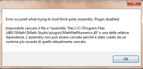

But seem that the framework is not compatible (.NET framework 4)... loading a plugin with a random function based on the math.net numerics plugin SMath disable the plugin (something like: "Can't load the assembly because it's created from a runtime newer than the currently loaded")
there is a way to bypass this issue?
