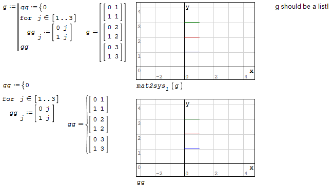

#2 Опубликовано: 14.06.2020 18:04:22
There might be other issues, but one of them could be the bug demonstrated here. Normally, no element assignment should alter the object type from list to matrix as it seems to happen in the line block definition. I think this is another regression, such stuff used to work in older versions (here 7251).
The original desparate workaround with str2num tries to handle the bug. Normally you should be able to reliably initialize a variable using any object of appropriate type.
Lists.sm (7,5 КиБ) скачан 1209 раз(а).
The issue demonstrated in the above post nails down to unexpected handling of single element lists used to initialize the data under numeric optimization.
