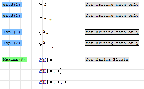

Glyphs for functions
  • requirements: SMath Studio 0.97.5737 or later (previous versions may have different features);
  • installation: SMath Studio: Tools > Plugins... > Online Gallery;
  • documentation: Файл не найден. Файл не найден.;
  • sources: SVN repository.

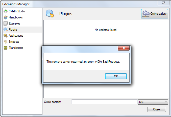

PSS. Once more to note the possible problem when frequantly installing/updating plugins from the Gallery (see the picture). If this happened, the only way is to delete the extension folder, and to install all the plugins again - AFAIK
Normally it is sufficient to delete the most recently installed plugins. Usually I have to delete the Maxima and the TableRegion directories.
I've never experimented the error in your screenshot, in the other hand the plugin updates sometimes (2 times, as for now) causes me workspace's "red cross of death" scrolling up and down worksheets ...

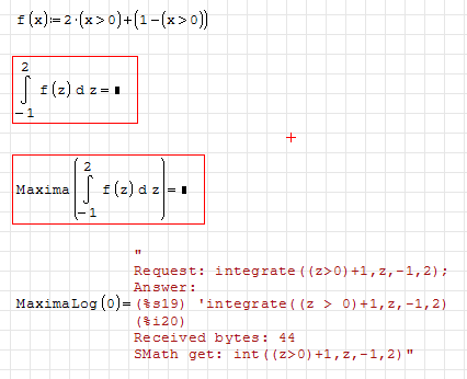

There is still quite something to do until we can symbolically integrate functions involving your operators. Maxima can do that only if the cases expand to sign() and abs() or possibly unitstep(). Perhaps we also could split the integrals appropriately at the interval limits and send the individual functions to Maxima.
I see, I don't know how to fix this (because anyway I'm expecting the use of booleans in the conditions - see the screenshots)
The at() operator currently can handle just very special types of expressions. We could map it to the at() function in Maxima, see attachment. We did so with the det() function in the recent update (announcement to come)
I'd like to add a function to make working at(2) and at(3) (indipendently from the Maxima plugin), let me know what I can do...

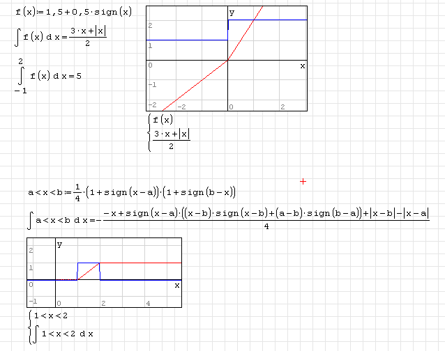

Maxima can integrate piecewise continuous functions, if they do not contain boolean expressions. Fortunately, there are workarounds for that. If you redefine the cases() functions in a similar way as apiecewise.PNG

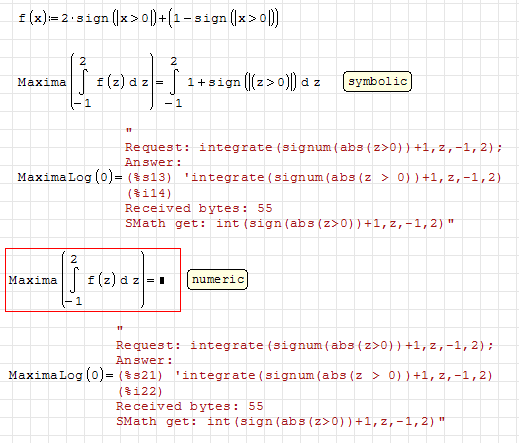

I miss something... why this doesn't work?
#7 Опубликовано: 24.11.2013 16:58:42
Handling of boolean expressions is quite different between Maxima and SMath. The way I proposed is inspired by how Derive (R.I.P.) simplified piecewise functions 20 years ago.
You could use abs() instead of sign(), that might work as well.
From the maxima manual:
The symbols < <= >= and > represent less than, less than or equal, greater than or equal, and greater than, respectively. The names of these operators are "<" "<=" ">=" and ">", which may appear where the name of a function or operator is required.
These relational operators are all binary operators; constructs such as a < b < c are not recognized by Maxima.
Relational expressions are evaluated to Boolean values by the functions is, maybe, if, while, unless. They are not otherwise evaluated or simplified to Boolean values, although the arguments of relational expressions are evaluated (when evaluation is not otherwise prevented by quotation).
[MATH]Maxima(is(1<2))=true@#[/MATH]
I do not understand the expression sign(abs(x>0)). if x>0, then the boolean expression returns 1, otherwise 0. abs() does not change that, neither does sign().
In SMath you can replace a
#8 Опубликовано: 24.11.2013 19:07:21
Okay, the problem is that cases output conditions and statements without preprocessing, so there are booleans... Maxima can't add (as general rule) an is() when there are boolean operators, or, if this is not possible, overriding the cases function?
The sign(abs(#)) was to reproduce the actual behavior of the symbolic cases(), that use any 0 value as 'false' and any not null value as 'true' (mainly to skip the preprocessing of the conditions and to avoid scaling factors)

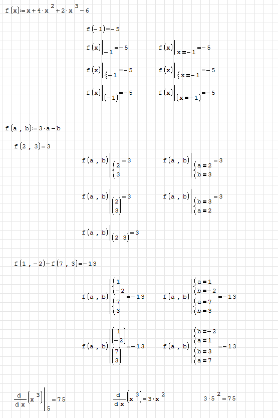

#11 Опубликовано: 10.12.2013 21:10:16
UPDATED
- at(2) and at(3) now are working functions
features:
* implicit equivalence needs a value for each variable, sorted alphabetically;
* with explicit equivalence (variable == value) the replacement could be limited to some unknowns or extended to anyone.
[edit] 1st post documentation updated

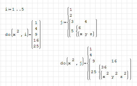

#16 Опубликовано: 07.05.2014 17:47:12
I've never used MathCad but looking the continuous posts the evaluation through vector elements seems like a drug
So I've planned to add something similar in this plugin; here's a screenshot of the undressed working function... I'm looking for a name, I've thinked to do(2) (because is fast to write - but this may be used hereafter for a do statement?) or maybe each(2)... if anyone has some better ideas about the name... b)
Best regards,
Davide
sergio 08.05.2014 03:08:00, Martin Kraska 08.05.2014 03:34:00, Radovan Omorjan 08.05.2014 04:36:00

The function was thinked to handle functions with scalar single unknown; I think could be extendeded to other cases using (implicitly) at(2) when there are more than a single unknown, limiting the evaluation at the first nesting level (or maybe not, looking from the deepest level and going up, but this is another step...). As for the "dress" I don't like a LHS+RHS approach, because in this case it would seem an assignment instead of a function (and if you place a function on the canvas without an evaluation, nothing happens); as first approach I've thinked to a modified version of at(2) or el(2), with some bracket [#] <#> or symbol @# near the subscript (BTW apply is not a bad idea...).
