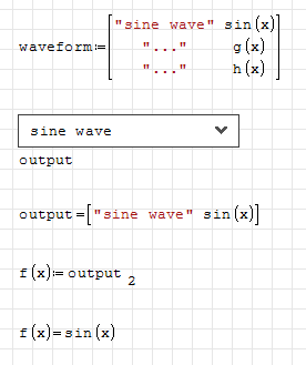

You might use combobox or comboboxlist regions
