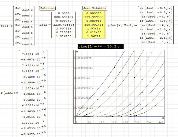

For this particular example, Carlos algorithm spits out in < hart beat !
Thanks again Carlos, it will surely help revamp some/many of the GenfitMinimize.
Levenberg_Marquardt_Code_CBG Copy.sm (65,28 КиБ) скачан 1329 раз(а).

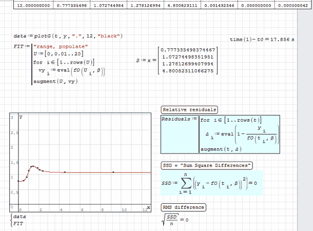

#6 Опубликовано: 21.09.2018 16:50:22
Hello Jean
Here is the L-M file that works with your example.
Thanks Carlos for doctoring.
By some regrouping, timing dropped from 3.8 min down to 2.6 min.
Niece Smath document for classroom and publishing.
Genfit Pharmacokinetics L-M Copy.sm (60,57 КиБ) скачан 1219 раз(а).

Another example of the application of the Levenberg Marquardt algorithm,
this time with the Tesla function.
Levenberg_Marquard_Tesla_OK_CBG.sm (546,62 КиБ) скачан 1341 раз(а).
