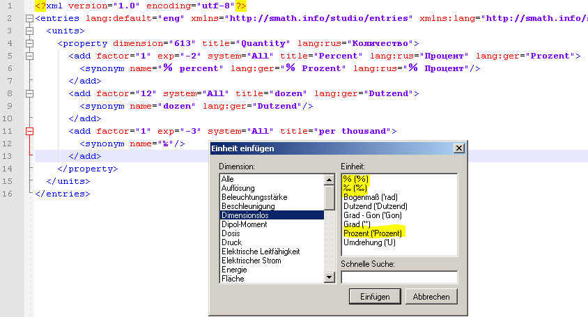

Here are some observations:
- The title strings, given in the tags do not appear in the unit selection list (I would have expected them as description strings).
- If a specific language title is given, then a language specific string is required in the tag, otherwise you do not even get the base version if the unit language is set to that version.
- That is, the only function of the title attribute seems to be suppression of the generic unit name, it makes a language specific unit name compulsory.
I would expect the title attributes to appear as descriptions in the selection dialog and in the dynamic assistant. Currently, just the unit names themselves are used, which just doubles the text.
I would expect to be able to use the generic unit names even if I specified a specific title. E.g. for percent, the description is language specific, but the percent sign is not. Am I really expected to provide the same string in individual languages once I choose to provide individual titles? This, however is only relevant if the title has some real use, otherwise no problem to just leave that attribute out.

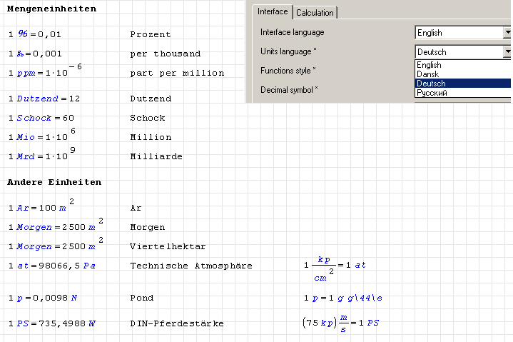

Here is the first attempt to restore the added units of the inofficial portable distribution within the new units framework of SMath 0.97.5280.
There is one more issue: somehow saving and re-opening the attached file leads replaces the unit 'vha by 'Morgen.
Obviously, I still do not really understand the file format, because I don't know how to add descriptions to the units, which are visible in the dynamic assistant and in the unit selection dialog.

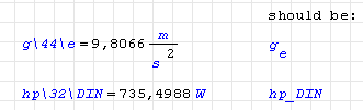

There are some formatting problems with text incdices and underlines in unit names. See attachment.
