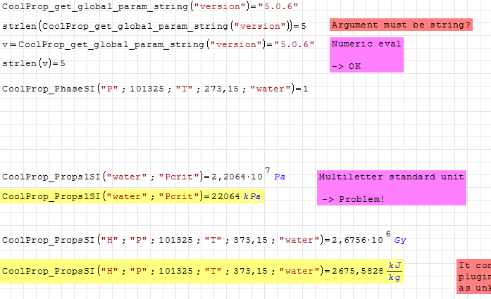

But when I try to assign units to the result (it is a physical properties library), it becomes complicated.
I use SMath.Manager.UnitsManager.GetCurrentUnitName() to get current built-in units names; I use SMath.Manager.Converter.ToTerms() and SMath.Math.Symbolic.Converter.ToMItem() to make proper MItem to assign to resulting TNumber's obj.Units. But it seems I do it wrong.
When the unit current name (e.g. 'K, 'm, 'J) is one-letter, it works OK. The returning result may be displayed by user using different units (say, 'F, 'in, 'kJ).
But if the unit current name is multiletter (say, 'mol, or ('J in Russian locale) 'Дж), the result is displayed correctly, but cannot be normally converted to different units; SMath handles the plugin-assigned unit as a "blob" and makes funny transformations to show "'mol/'{m^3}" as "'kmol/{m^3}".

The second is when I make functions that return strings. There seem to be no "string" type in SMath. Instead, strings are a kind of TDouble with isText set to true. I make string results as
new SMath.Math.Numeric.TDouble("\"" + String + "\"" );
This produces a number with isText properly set to true.
But when such a function is used inside other that requests textual arguments, an error is emitted that says "Here must be a string!".
What is wrong with the code?

My experience with numeric interface is limited to a couple of plugins, but I've not noticed obvious errors; therefore I've tried a "mixed approach" like in the GPCWrapper (code written with numeric library and I/O handled with lowlevel evaluation) and as you can see from the attachment this works fine, thus the core of your work basically it works (and the issue probably is in the IPluginMathNumericEvaluation.NumericEvaluation, or maybe we are missing something else...)
The implementation is a little bit naive, just to make the test
- input arguments are not preprocessed (overriden with values taken from your debug file)
- units in some cases uses new MItem() instead of unit(uname()) (this approach seems better but I don't have idea if it works with localizations)

I seem to have solved the units problem.
Unfortunately, the new MItem(string) doesn't handle localization; thus I had to keep using the long way.
It turned out that it is crucial to call Expression.SimplifyEx() upon MItem. And taking into account that there's no context in numeric evaluation available (or I miss it), I had to split all the units to basic SI parts (e.g. Pa -> kg/{m*s^2}). Then the units work as intended, and localization works.
The second problem (text that is "not text") seem to be over my skills; hope that someone could shed some light there.
