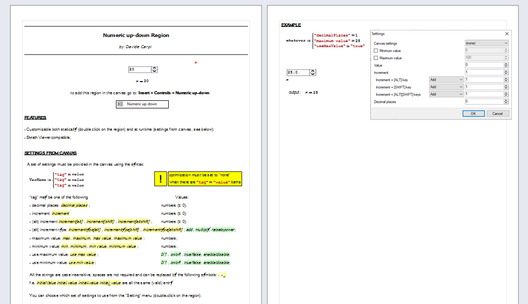

#23 Опубликовано: 30.12.2021 09:13:29
Hello Sergio,
I'm not able to reproduce this behavior. Can you check if it happens to you even in a clean portable build on the same machine?
That's the expected layout:
2021-12-30 12_55_25-SMath Solver - [downloaded_Numeric up-down Region.sm].png

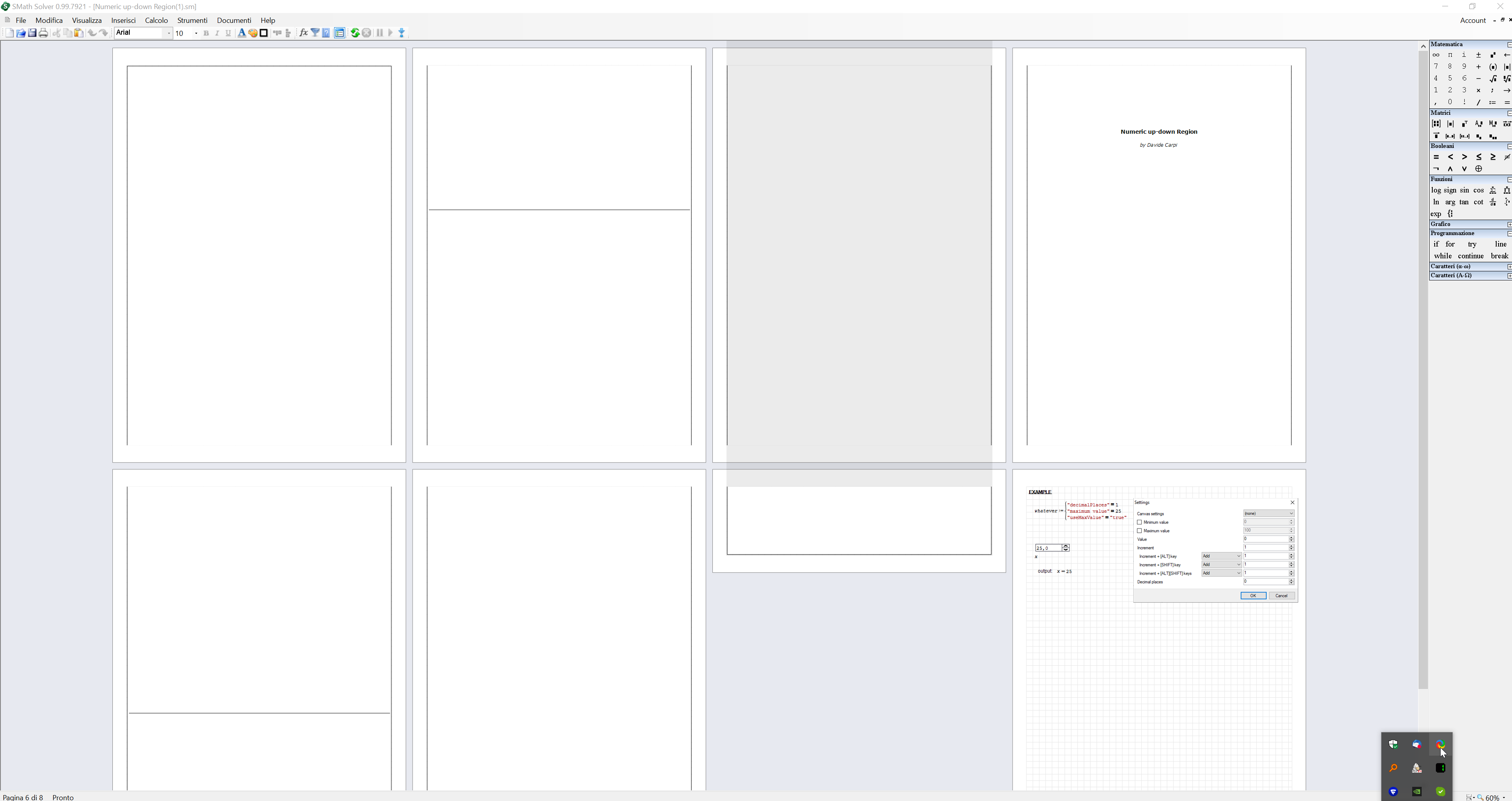

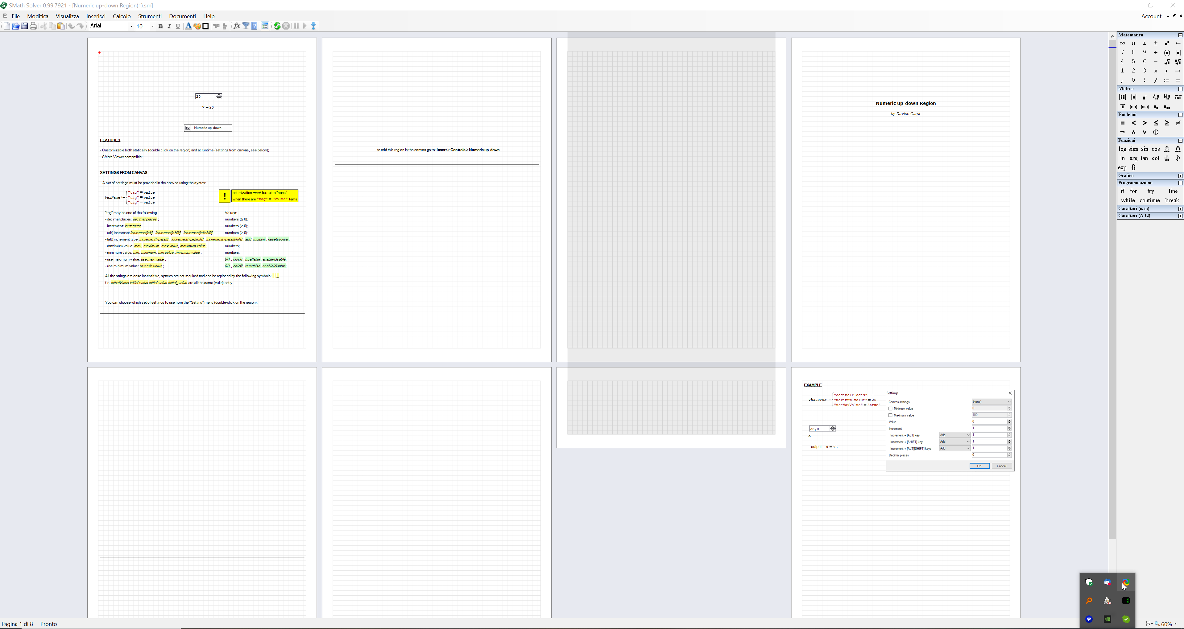

#24 Опубликовано: 30.12.2021 12:03:01
I tried a clean portable version (obviously uploading the file I was asked to install plugins: Numeric Up-Down and Writer) by detecting the same problem. I attach the first image is how the file is presented at the opening and the second image is what happens by clicking on the canvas.

#26 Опубликовано: 30.12.2021 13:25:44
Overlord, I tried to do what you suggested even if the content characters are present in my PC because very common on Widows (Verdana, calibers etc ..). In fact he did not give the desired result. But the experiment was useful to understand that when I click on one of the white areas that are generated by the "Writer Region" plugin the character for the area was set up to a dimension 975 (ie the point or the comma is lost according to of the language of 9.75). Resetting the size to 10 the area resumed a normal size and the layout of the file was more compliant with how much posted by Davide (but not perfect yet). The sentence is therefore that the problem is linked to that plugin "Writer Region".

#27 Опубликовано: 30.12.2021 13:41:30
Thank you very much, the problem about the decimal place is probaly related to some localization setting, I think I can fix it easily.
TBH I'm more concerned about the second Writer Region ("to add this region in the canvas...") that is somehow pushed down, unlike the others.
