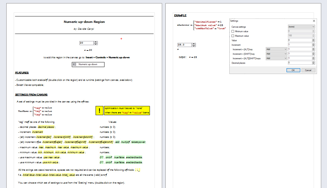

Hello Sergio,
I'm not able to reproduce this behavior. Can you check if it happens to you even in a clean portable build on the same machine?
That's the expected layout:
2021-12-30 12_55_25-SMath Solver - [downloaded_Numeric up-down Region.sm].png

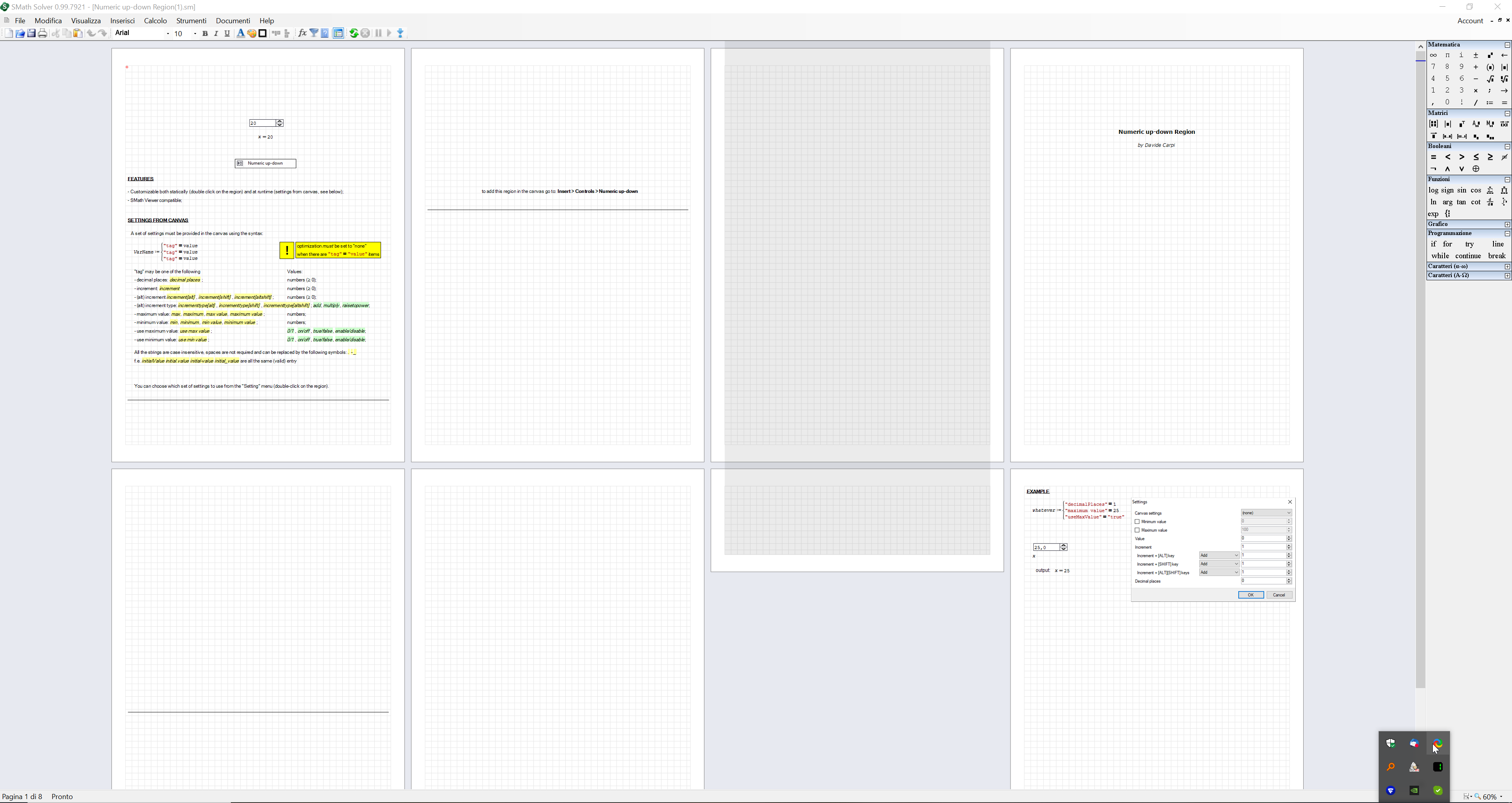

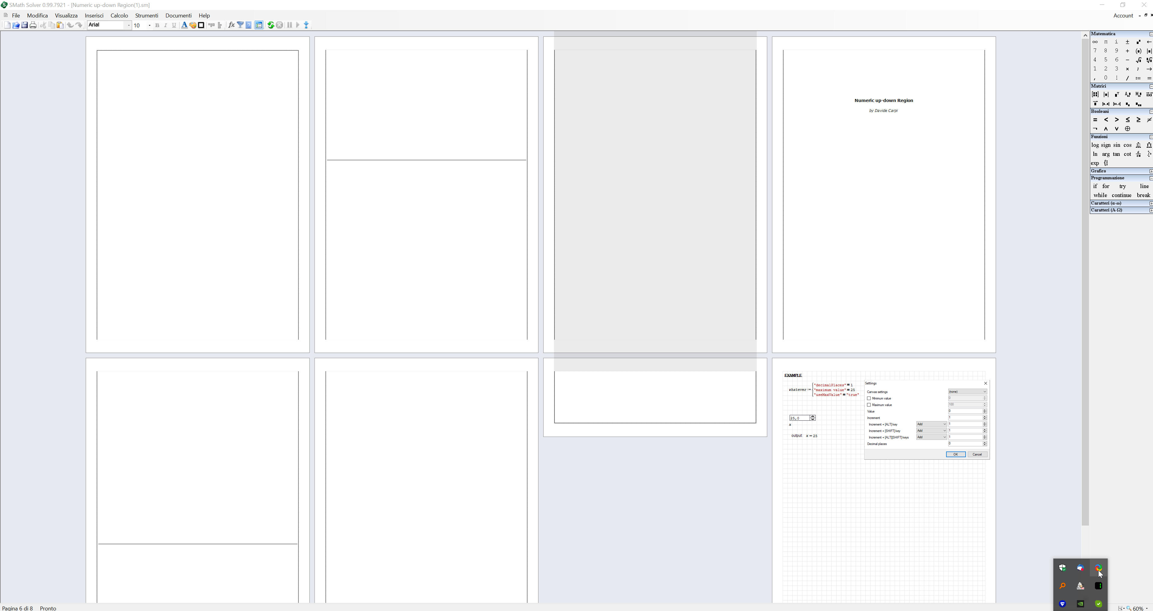

I tried a clean portable version (obviously uploading the file I was asked to install plugins: Numeric Up-Down and Writer) by detecting the same problem. I attach the first image is how the file is presented at the opening and the second image is what happens by clicking on the canvas.

#25 Posted: 12/30/2021 12:21:36 PM
