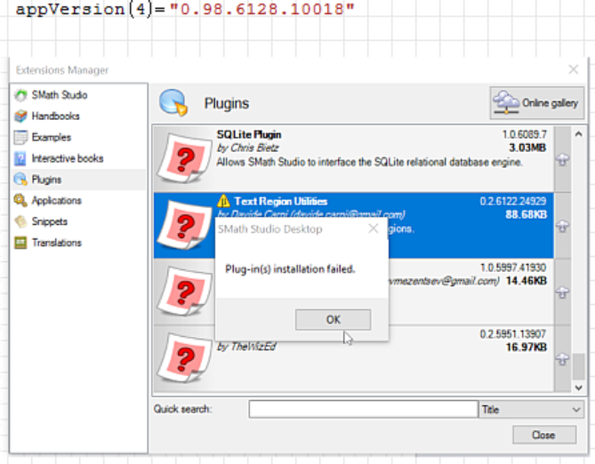

Unable to install Text Region Utilities plugin in 98.6128

Davide Carpi 12.10.2016 10:36:00
#2 Опубликовано: 12.10.2016 10:35:31
thank you, I'll fix it ASAP
#3 Опубликовано: 12.10.2016 11:39:21
2 343 сообщений из 4 055 понравились пользователям.
Группа: Super Administrator
Davide, I've already fixed it by simple plug-in rebuild. Sorry, had no chance to inform you.
New version of the plug-in can be installed with no issues.

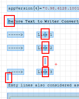

The "insert a toolbox" in Text Region Utilities Plug-in exibit erratic behaviour.
1. It shifts the selected text to a new position.
2. Apparantly, the empty lines between text lines are also considered as text?
3. Had to press "Apply" more than once to convert all selected text.

#6 Опубликовано: 13.10.2016 05:55:24
Thank you NDTM,
Fixing it, there were some changes in the API.
I'm not able to reproduce it; if you save the document with text regions and you load it again it still happens? If yes can you attach it here?

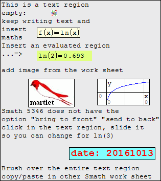

#7 Опубликовано: 13.10.2016 10:24:20
I don't understand what a "Tool Box" could be ?
Smath 5346 "Text Box" allows lot of decoration.
Decoration for a Web page presentation for instance.
As an Engineering working document: decoration is
too much, IMHO.
Each Shift/Enter adds blank line(s), an empty space
where to slide: images, graphs, foreign text ...
#8 Опубликовано: 13.10.2016 10:52:19
NDTM Amarasekera
NDTM Amarasekera
Thank you Davide!
The original file is attached; the problem still exists even after saving and re-opening.
Before Text Converter.sm (73,44 КиБ) скачан 1309 раз(а).
Davide Carpi 13.10.2016 11:11:00
#9 Опубликовано: 13.10.2016 11:23:02
Thank you, is exactly what I was thinking. If you select all (CTRL+A) you can see some empty text region, probably created with an UNDO action (because my bad coding in the converter feature). Should be no more an issue with the coming plugin update (but if existing you have to remove them manually).

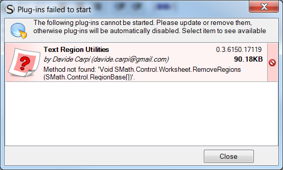

#12 Опубликовано: 15.12.2016 14:43:38
Alexander O. Melnik
Alexander O. Melnik
Plugin does not seem to work in latest SS 6179
#13 Опубликовано: 15.12.2016 15:22:31
Thank you Alex,
recompiled, try now.
sergio 16.12.2016 15:41:00
#14 Опубликовано: 16.12.2016 15:34:02
Alexander O. Melnik
Alexander O. Melnik
works fine now, thanks!
