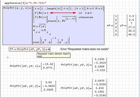

WroteThat's my solution
- to separate the functions from matrix building,
- to use vectorize for speed
Apparently, the function f(#x):=1 if n=0 has a problem?. Or is it redundant?
For values n>0, the "otherwise" condition yields correct results irrespective of values in "if" condition.
Please check.
just put the 1 into a 1x1 matrix. That's all.
(And if you want to use units with the X Vector, just remove the eval and evaluate symbolically.)

WroteWroteThat's my solution
Please check.
Wrotejust put the 1 into a 1x1 matrix. That's all.
Hi
Still the same error when n=0.
Better if you can post the SM file please.
Sorry, I didn't realize, that vectorize behaves unexpectedly (to me), when the function does not include 'x'.
So I changed f to f(x):=[1+0*x] and now it works. The file is attached.

I would expect the results of g and h to be the same, and to be a 3 items long vector.
PolyFit.sm (11,92 КиБ) скачан 1267 раз(а).

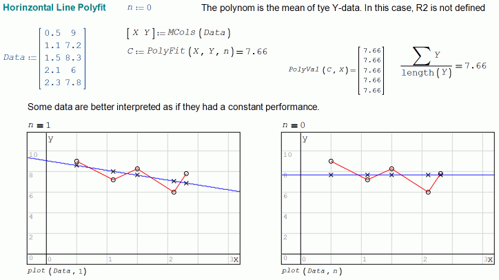

Hi. This is in case you want to interpolate with an horizontal line.
PolyFit.sm (159,33 КиБ) скачан 1312 раз(а).
PolyFit.pdf (748,27 КиБ) скачан 813 раз(а).
